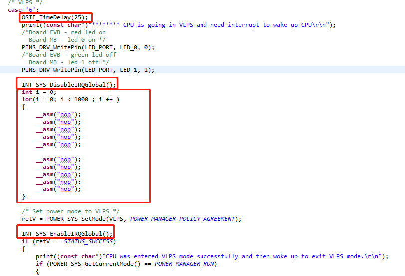

    SysTick  will affect entering into VLPS?
   when I am debugging,the SysTick  is tunned off before entering VLPS,it stops。
   when I am debugging,the SysTick  isn't tunned off before entering VLPS,it do not stops,why?

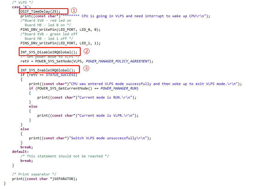

liuruowen
dianabatrlova
Hello:
      So,you only add OSIF_TimeDelay(25) under the "case '6': ",you can try it below:
Add the code of "① ② ③ ", It will exit the VLPS mode directly. It didn't work as I expected.
Add the code of "② ③ ", It wll work normally。

dianabatrlova
Hello
I have tested the same code as you shared with me and VLPS works as expected. I was able to enter into VLPS with additional code "① ② ③ ".
I assume the root cause of your issue is that the debugger is still attached. Important note: the power cycle is required after debugging.
Also, I recommend you to use the newest SDK version S32 Design Studio for ARM 2018.R1 - Update 10 available
I hope it helps. If not, could you please share your project?
Diana

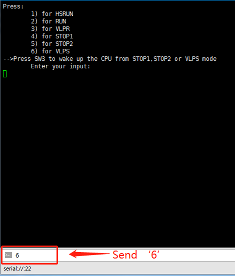

liuruowen
dianabatrlova
Hello:
      Please check the attachment, the attachment is my project.
      Below is the environment  I tested:
1)Press Reset Key, See below:
2)Prepare to send ‘6’ ,Select “6) for VLPS”, see below:
3) Send send ‘6’,see below:
2,956 Views

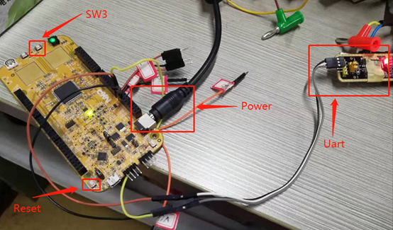

dianabatrlova
I have tested your code and still cannot reproduce your issue.
Please, see the steps after the load project:
I'm using OpenSDA UART.
1. Disconnect the power supply
2. Connect the power supply and press reset and press key number '6'
Also, I measure the current 0.15 mA which confirms that MCU is in VLPS mode:
Diana

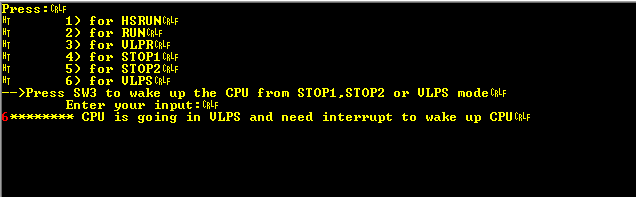

liuruowen
dianabatrlova
   Sorry,Maybe I didn't disconnect the power supply last time, causing problems.
   But,trouble you here is trying the code below:
 1 disconnect the debuger;
 2 disconnected the power supply;
 3 connect the power supply and reset;
 4 first ,it can enter VLPS, second ,it can not enter VLPS( exist from VLPS directly)。

dianabatrlova
In this case, It is woken up by the pending interrupt.

dianabatrlova
I would like to apologize for the delay. I recommend you to look at the ARMv7-M Architecture
Reference Manual https://static.docs.arm.com/ddi0403/eb/DDI0403E_B_armv7m_arm.pdf
In this case, the exception becomes pending after the global interrupts are disabled.
You can test that if you comment the INT_SYS_DisableIRQGlobal() function, the MCU enter VLPS successfully.
Note: The SysTick pending status can be clear by PENDSTCLR bit located in ICSR register. This bit removes the pending status of the SysTick exception.
