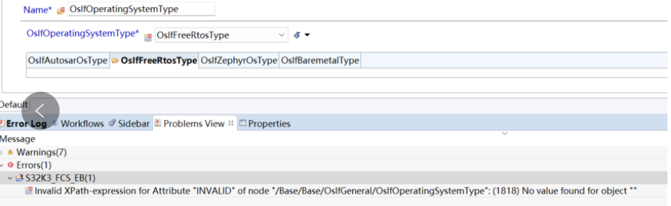

S32K3 How to setting FreeRtos with EB 29 for RTD2.0.0?

Hi, all
    Where can i get more information?
DRs,
      xianlong

Hi xianlong,
This error is a bug of driver RTD_S32K3XX_2.0.0. This bug was raised with the ticket ID: ARTD-26627
It will be fixed in the next release.

@DanNguyenDuy Hi,Dan
I have updated it to RTD2.0.1, but....
Will this bug affect the normal use of FreeRtos? If I ignore this error.
If so, is there a way to solve this problem?

Hi wuxianlong,
The RTD2.0.1 version still fixed this error not yet. At the moment, I saw that this error was fixed on the RTD_4.4_S32K396_3.0.0_CD01 and RTD_4.4_S32K358_3.0.0_CD01.
To solve this problem on the 2.0.0 version, you must select it is "OsIfBaremetalType" or "OsIfAutosarOsType"
Dan

Hi,Dan
Thank you very much. This question has been bothering me for a long time.
