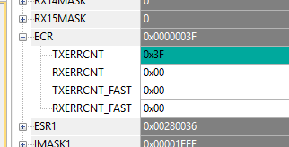

When disabling the CAN module, I am proceeding exactly as you describe, as seen in my original question. 1. Entering Freeze mode 2. Disabling module and polling the LPMACK 3. Disconnecting clock in PCC. Disconnecting the clock first, than modifying the control registers would result in a HardFault anyway.
After wakeup, I can see exactly the conditions you describe for bus off status. BOFFINT is set and TXERRCNT is increasing. I'm attaching screenshots from Keil debug session.

PetrS
Hi Tomas,
is there any message transmitted upon wake up? Check bus signal. Check correct bitrate generated on TX pin.
If nothing should be transmitted before you get in to Bus off check MB area for correct values.
Anyway it points for bit timing issue, wrong config or different PE clock
BR, Petr

Sorry for a hasty question, I just found the source of my problem. Both CAN module and clock were configured correctly, but in our ECU we also use UJA113 System base chip as voltage regulator and CAN driver. When entering the VLPS, I configure the SBC to shut down voltage regulator for other peripheries (not the MCU) and CAN transciever, but after wakeup I forgot to tell the SBC to activate the transciever and V2 again. As a result, there was no traffic on the SBC-MCU CAN Rx line and Tx entered busoff because of the missing ACK signals.
Thank you for your time!
