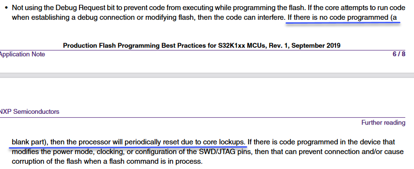

I'm working on a project using S32K144 and saw that there were period reset signals on the MCU reset PIN on a brand new PCBA.
I thought something goes wrong with my external reset circuit. But after I disconnect all of my external reset circuit including the capacitor, the period reset signal comes from the MCU itself.
I googled some and some people are mentioning same phenomenon.
It's not a problem to me but trying to convince other guys.
So, can you help to point out if it's correct behavior? And do you have a document like mentioning this behavior?

Hello @HMSwitches,
This is taken from AN12130 Production Flash Programming Best Practices for S32K1xx MCUs, Chapter 5 Common problems.
https://www.nxp.com/docs/en/application-note/AN12130.pdf

Thank you Daniel, that's helpful.
