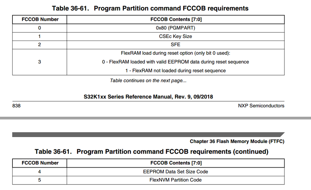

The follow table is the Program partition command .

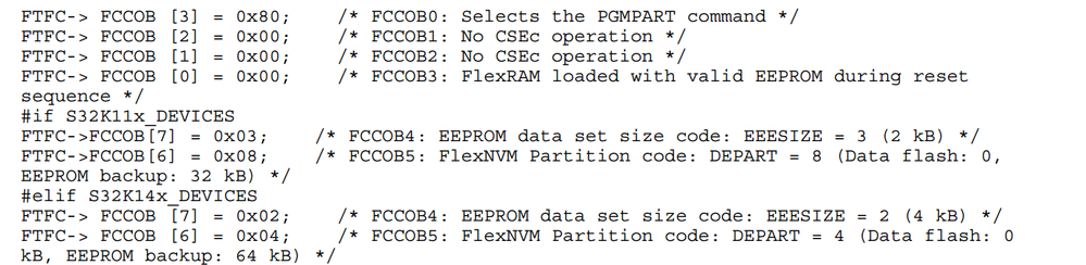

The code is the Program partition command examples.

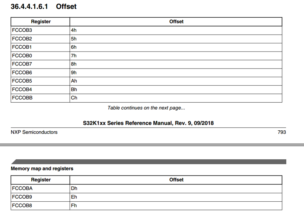

   My question is that the FCCOB Number 0 is 0x80,but the code is FTFC->FCCOB[3] = 0x80.
   Why was not FTFC-FCCOB[0] = 0x80 but FTFC->FCCOB[3] = 0x80 ?

I checked the reference manual and I had found the answer.Every resgister 's offset is different than index number .
