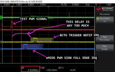

I'm working on an automotive project that I need to handle some calculations regarding motor angle at very specific time. As far I've setup my peripherals ADC, BCTU, DMA, TRGMUX, eMIOS, LCU and others....
I believed that I could use the BCTU trigger notification in order to get an interrupt CB running at the same time that BCTU get's triggerred but it seems that there is a bit delay between the trigger and the CB function being executed.

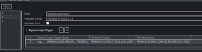

I've used trigger mux in order to drive the eMIOS MCL signal out in a pin.
And I'm using SIUL2 in order to toggle an other  pin within the BCTU's trigger CB function in order to check timings.
I have also changed priorities in all other interrupts that I'm using. I've turned them to 5 and 4 and BCTU trigger is set to 0.
The thing that I've noticed is the image bellow:
RED line is the eMIOS0_22 RELOAD_OUT signal from trigger mux and the BLUE line is the IO that I'm turning on/off within my CB function.
I've also used persistence mode in the oscilloscope in order to see the timing diffs. My trigger is taken from the RED line.

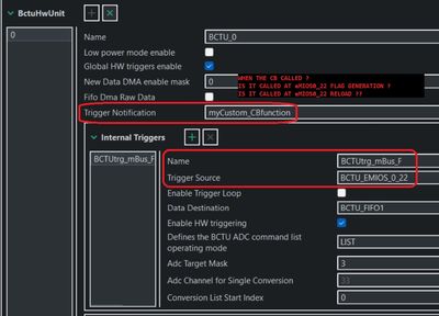

Now some questions:
1. Can someone let me know why there is such big delay since the eMios signal until the CB being called ? It is like 32uS after the timer signal.
2. Is the signal eMios0_22_RELOAD_OUT the same signal that triggers the BCTU ??
3. Can you suggest me anything in order to get a CB running the OverFlow or UnderFlow of the eMIOS MCL timer ?
4. Is it possible to point me out to any extra documentation that could help ? I've read the reference manual, and some BCTU, LCU ppts.
Kind regards,
kyf.

BCTU trigger notification is called (if enabled) when TRGF flag is set, that is when ADC is triggered by BCTU. There are four clock cycles from assertion of a BCTU trigger input to assertion of the first trigger output to the ADC, if ADC is not busy.
The trigger input BCTU_EMIOS_0_22 correspond to channel flag, not eMios0_22_RELOAD_OUT signal. But this can be asserted at the same time for channel configured in MCB mode.

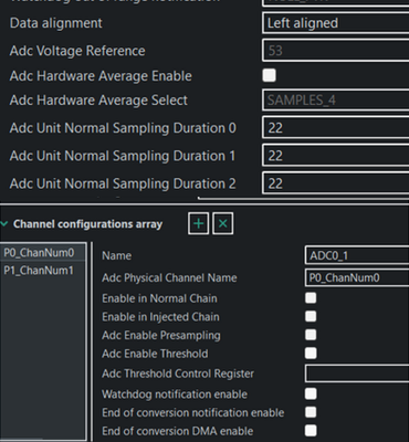

How are the triggered ADCs configured with respect of clock and sampling duration?

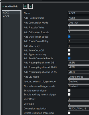

regarding your question: How are the triggered ADCs configured with respect of clock and sampling duration?
Those are the configurations of the ADCs. I have an ADC list (2x ADC0 channels and 2x ADC1 channels). The BCTU is triggered every 10KHz by the BCTU_EMIOS_0_22 channel which is configured in MCB mode.

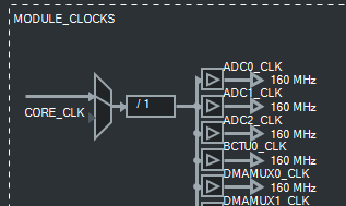

Clocks are 160MHz (ExternalOSC + PLL) and the prescaller value of the ADC is 2 in both channels.
