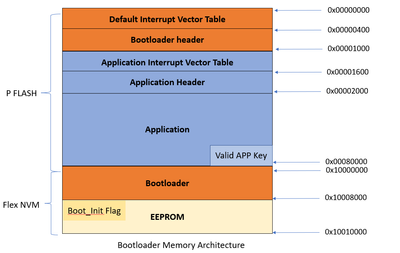

We have implemented the UDS based bootloader for the in-place update , below is the memory partition for the same & it is working really well
Orange --> Bootloader , Blue --> Application
So right now , Host(GUI) will take the application .srec file as a input & upload the firmware through CAN-CANTP-UDS
Next I want to implement the bootloader for the A/B Swap Update , I came to following conclusion regarding the same
  • The Application file should be placed in both FW locations ( .srec file will have application in 2 locations)
  • GUI will be sending the Application for both FW locations
  • But Bootloader will have a logic to take only one FW(Neglect CAN messages of other FW) , & flash only that part of FW PFLASH
So let me know if I have taken the right decisions related to A/B Swap firmware , If this is not a right way , Please suggest a good method to do the same

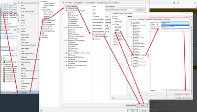

Considering I need a srec record having application in both the FW locations , I tried modifying the linker file by memory partitioning & modifying the SECTIONS part
But I'm not able to generate a .srec file having application in 2 different FW location
Please help me resolve this
