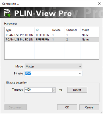

PetrS
I connected interface as master with 9600baud
then added 2 frames as I wrote, one frame to publish (sent) 8 bytes with ID=1 and second to subscribe (receive) 8 bytes too with ID=2. Classic checksum used.
After triggered (manualy) slave properly receive payload or respond back, that shows in PLIN View receive section.
BR, Petr
