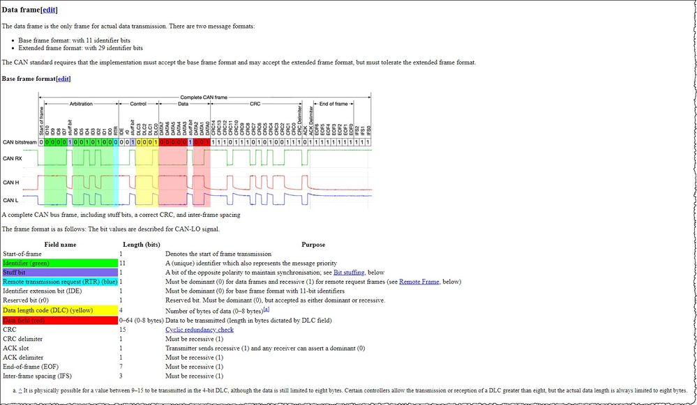

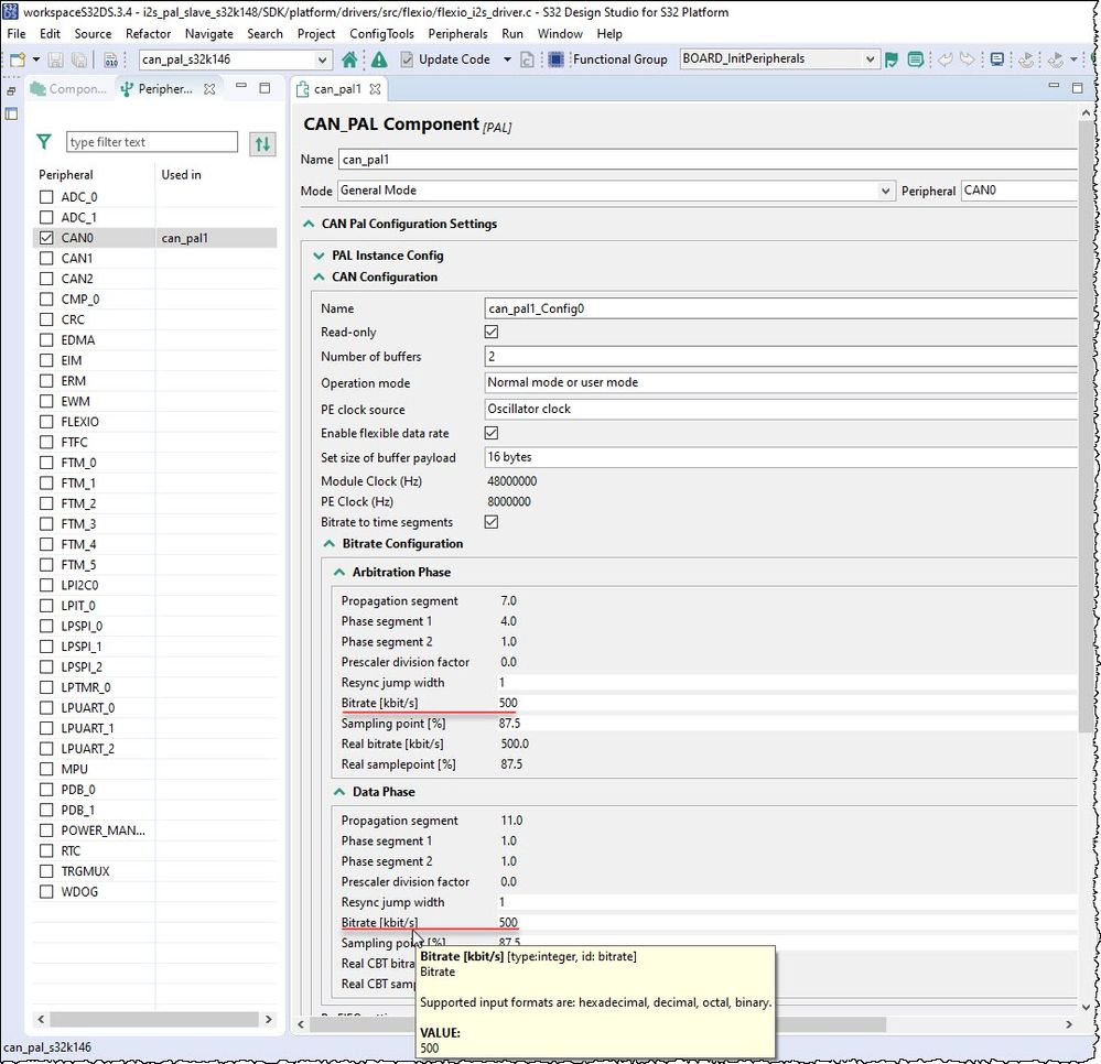

What Bitrate did you set for the Arbitration Phase and Data Phase?(The CAN_PAL demo set 500 kbit/s by default)

yfliu
Robin,
The bitrate we are using is 1000kbps as mentioned in the subject .
Yanfeng
