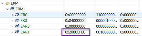

I use EIM to enject a Non-Correctable Error for SRAM_U on board S32K146EVB, but the code alwarys stops at "EIM_DRV_Init();" ,  if suspend, it stop at " b       DefaultISR".  And when I run the demo in our developing code, it reset the board directly.  but if operates EIM registers directly, instead of EIM_DRV_Init, it run well, I can get the right error address,  but I can not get the right value, for example , the address is set value 0x30, after enject a NC error, the value should be 0x33 if data mask is 0x00000003, but I get the value still 0x30.  I use address 0x2000EBF0 to test, the address is not over the range. So whether have some special attention for SRAM_U to enject an ECC  Non-Correctable error?

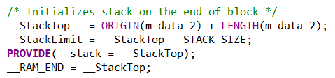

There is the Stack at the end of the SRAM_U region.
The EIM module is enabled in the EIM_DRV_Init() function, then it goes back to the main() function and generates a fault exception on the stack access.

Hi Daniel,
I understand,  if use "EIM_DRV_Init" for SRAM_U, it can cause an INVSTATE UsageFault exception on stack access. so I can use the way in SRAM ECC injection example, to avoid use "EIM_DRV_Init". thanks very much.
