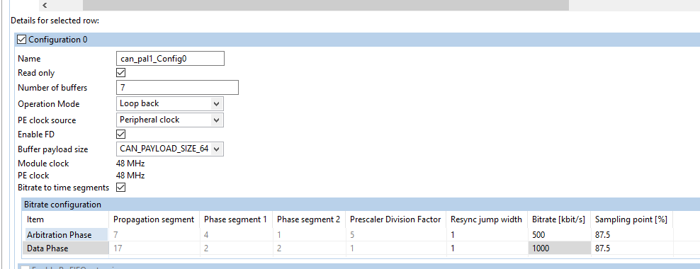

Work mode is loopback
code as above,the problem is :recvMsg I found is as follow:
01 02 03 04 05 06 07 08 0F 5A 38 02 94 00 00 00 01 02 03 04 05 06 07 08 09 0A 0B 0C 0D 0E 0F 10 11 12 13 14 15 16 17 18 19 1A 1B 1C 1D 1E 1F 20 21 22 23 24 25 26 27 28 29 2A 2B 2C 2D 2E 2F.I dont know why ?CAN anybody help me ?Thanks.

I modified can_pal demo example (SDK3.0.0) for loopback mode and 64byte payload and after testing on the EVB I see correct data received.
So see no issue here.
BR, Petr
610 Views
alexandrunan
Where is the driver Init function ?! And what is the configuration of it ?!
If you configured the Driver in non FD mode will send only first 8 bytes of message.
Second please check you functions return status in case something is not configured ok, will return a different status than STATUS_SUCCESS.
What version of SDK do you use ?
