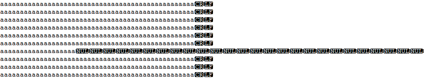

Hi All,
Ive been working on writing to a text file on an SD card using an MPC5748G with processor expert generated code(SDHC,FATFS) this works ok but i am trying to increase the write speed. I have found that the speed of the transfers is proportional to the amount of data I write to the SD card however I can only go up to around 1050 characters in a call to f_write or I end up with corruption of the file by which I mean I see null characters (\0) written to the text file.
can anyone help me to either improve the write speeds with transfers < 1000Bytes?  or could someone help me to increase the amount of data I can transfer at a time without it getting corrupted?
Ive added my data from the transfers from 1 to 1100 characters to the sd card done 20 times each
Many thanks
Liam

This function seems to work ok however I am seeing corruption of the data on the sd card with NULL characters added into the text files.
 I used the debugger to see if there was any null data in my buffer but there isn't so i really don't know where it comes from. i have run some tests and have found the conditions that lead to the corruption... it seems as though if I only write small (< ~1000 characters)  amounts of data to the SD file it works fine, if I only write large(> ~1000 chars) amounts of data its also ok...but if I do a mixture of writes some more than aprox 1000 characters and some below aprox 1000 characters then i will see corruption of the data (the boundary isn't 1024 though I checked that). the code below shows this.(the databuffers are prepopulated)

Edit: I have just noticed when I was tidying up my code to put on here that there seems to be a time factor(how long waited between calls to WriteBuff_1()) that effects if there will or will not be corruption to the file.
If anyone could help me in figuring this out id be very grateful.

Gus_Guzzler
Hi Liam,
The solution to this issue is to change these 2 lines of code in S32_SDK_S32PA_RTM_3.0.0\middleware\sdhc\fatfs\usdhc_fatfs_impl.c file:
line 306 :
                    status = SD_ReadBlocks(card, g_bufferedData, sector, 1U);
to
                    status = SD_ReadBlocks(card, g_bufferedData, sector + j, 1U);
and line 397:
                    status = SD_WriteBlocks(card, g_bufferedData, sector, 1);
to
                    status = SD_WriteBlocks(card, g_bufferedData, sector + j, 1);
To improve writing/reading speed use buffers address location that are aligned by 4 bytes, and sizes of the buffer multiple of 512 bytes. If the size of the buffer is to big for your application use the size of the buffer at least multiple by 4 bytes. If these conditions are not meet additional copy will occur in to internal buffer that is aligned by 4 bytes.
Nicu.
