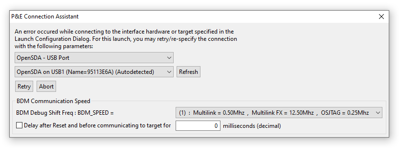

Thank you very much I managed to import the project but I have an error when I debug the project.debug.PNG
853 Views

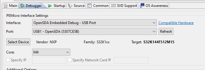

dianabatrlova
What happens when you click the "Retry" button?
Are you able to build the project without any error?
May I see your debug configuration?
For example, I'm using OpenSDA so my settings see below:
Diana
853 Views
abderrahimjamao
thankyou, it was a bad contact between the shield and the board.
