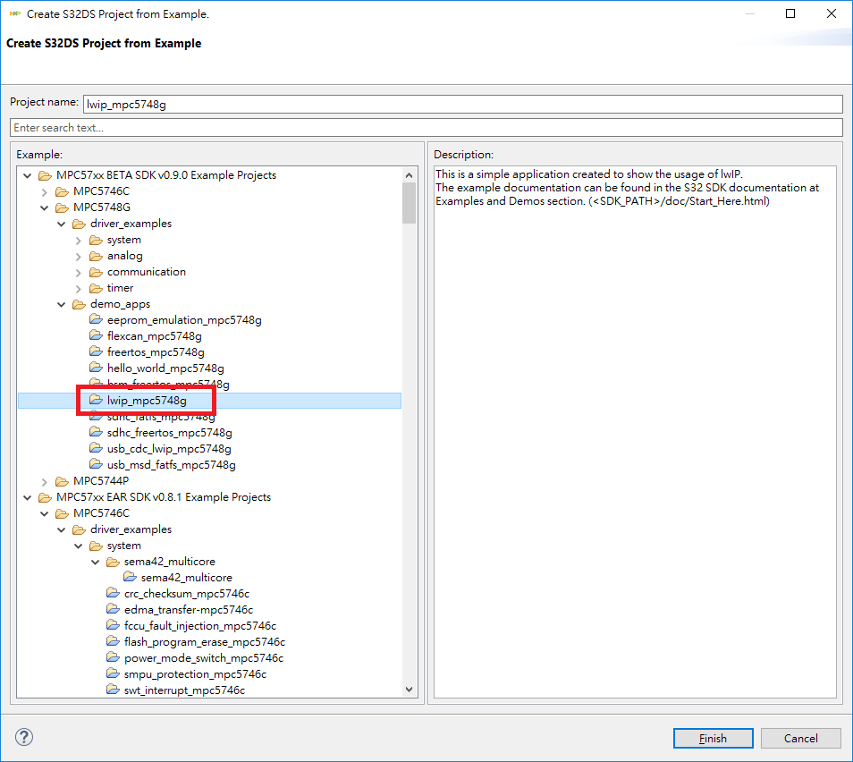

I have import the SDK V0.9.0 example code and the lwip are FreeRTOS, but the CAN, LIN don’t have FreeRTOS.

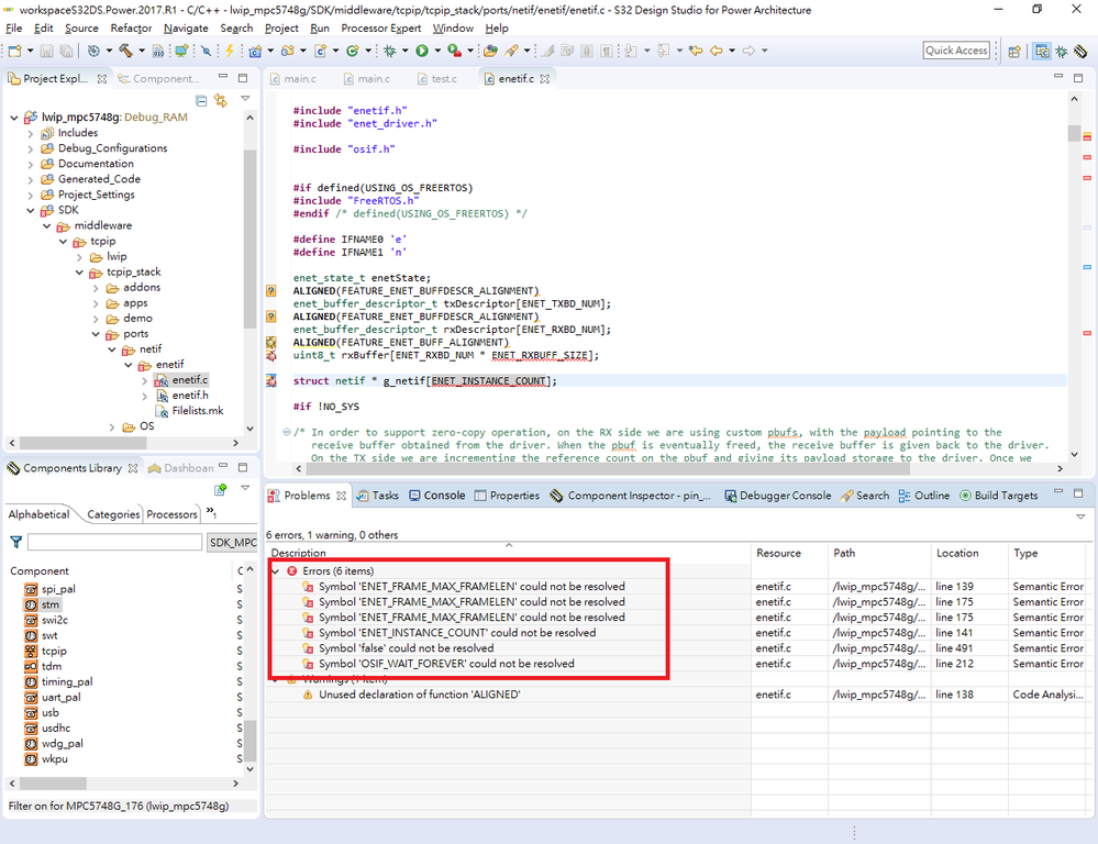

BTW, I had try import lwip_mpc5748g to try. If I don’t do anything then direct to build it. It’s OK don’t have any error.001.png
But I want to see the detail code then open the SDK code .c file, it will show many Errors then I can’t build again.

finally - got it. I used MPC5744P instead MPC5748G and can reproduce the issue. It is known eclipse issue with false-positive errors. You can build your project normally (you got the .elf file). To fix it just rebuild index - Right click on project name -> Index -> Rebuild
Thank you for report. IDE team is hunting this error for a while and we still don't have reliable reproducible case. This one looks like 100% reproducible.

1. import sample code.
2. Build Configuration → Set Active → Debug_Flash
3. Generate processor expert then start build.
As you see, I don't add "linflexd_uart". it's not any errors.
4. I double click the "enetif.c" file then it will show many error.
