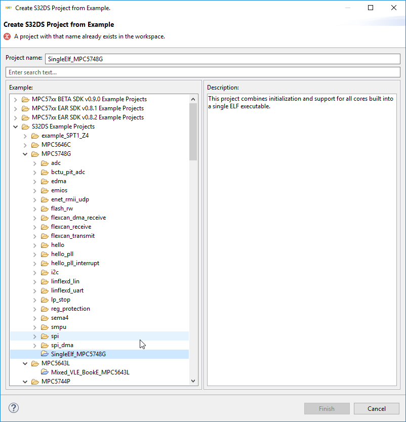

quick update - I just realized that there is example for single multicore MPC5748G elf already in S32DS Power v2017.R1 (but without SDK):
Hope it helps.

Thanks Jiri. I did eventually notice that one and the 5777c example in the community
The more difficult aspect is using the sdk driver as a shared resource. I’ll have more talks with the customer to see how they might block access for running from flash or spawn multiple versions in ram to execute. Maybe they are not contemplating the ramifications of shared resources

we have example related to multicore single elf - https://community.nxp.com/docs/DOC-335462
About SDK resources sharing across cores - I'm afraid that easier way will be create project without SDK. May be someone from SDK team will explain how to do it easily with SDK, but for me it looks too complicated with the generated code and so on.
In SDK are some multicore examples - you can look at them (interrupt_control_multicore and hw semaphores).
