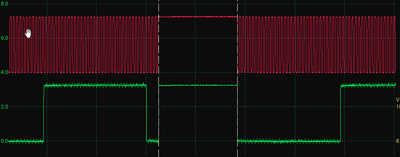

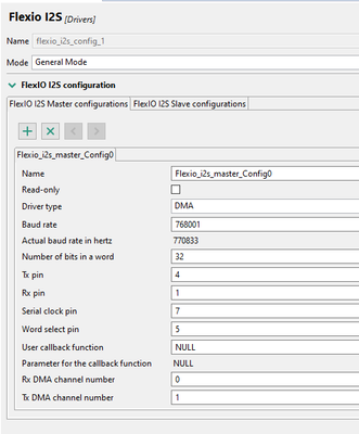

I'm using S32K142 controller for I2S communication.
I configured I2S through SDK drivers and sending audio buffer continously.
below is  screenshot in which we are facing gap in SCLK and due to that other clocks are being disturbed.
configuration:
using following function to send data in infinite loop.
uint8_t I2S_DataBuff_u8[] = {0xAA,0xAA,0xAA,0xAA,0xAA,0xAA,0xAA,0xAA,0xAA,0xAA,0xAA,0xAA,0xAA,0xAA,0xAA,0xAA,0xAA,0xAA,0xAA,0xAA,0xAA,0xAA,0xAA,0xAA,0xAA,0xAA,0xAA,0xAA,0xAA,0xAA,0xAA,0xAA,0xAA};
FLEXIO_I2S_DRV_MasterSendData(&I2SMasterState, I2S_DataBuff_u8, 32U);
please share solution , how can I continuous send data.

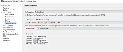

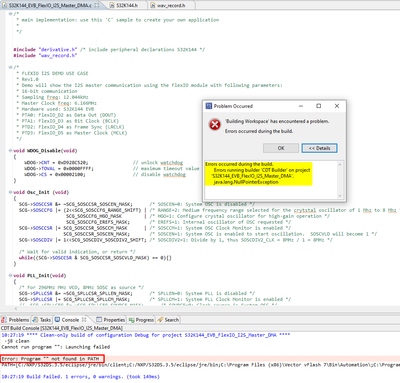

I tried to import code and build but it is not building successfully. error is attached below.
additionally if Build for release it is building successfully.I tried to check issue for debug_flash mode but following issue it there
so I tried with S32Ds for ARM IDE but having same problem.
please share details how can I remove error.

Hi Mohit,
In S32DS 3.5, create a new project (without SDK) and copy the cource code from the example.
It should work this way.

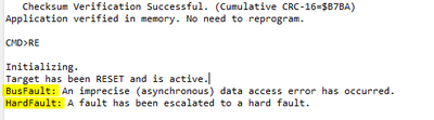

Mohit_Manvar
I tried to check causing of fault and I got this.
please briefly explain where should I call fault handler in code and how can I use it?

danielmartynek
Hi @Mohit_Manvar,
I'm sorry for the delay. I see now that the project has been built for the first maskset of S32K144 where DMA clock could be gated in PCC[CGC]. This was removed on the current version of the MCU.
Just comment this line out:
// PCC->PCCn[PCC_DMA0_INDEX] |= PCC_PCCn_CGC_MASK;

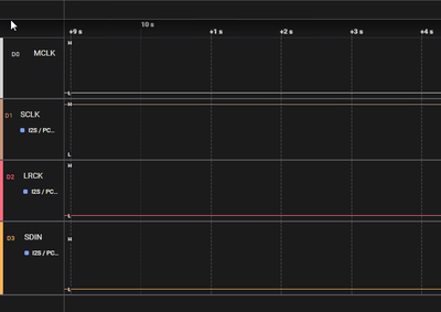

output pins:
please suggest your thoughts.

Hi @Mohit_Manvar,
Unfortunately, we don't have the capacity to port and debug every example right now.
The examples are provided AS IS.
