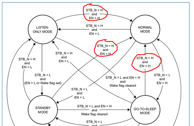

Jeevi
Hi @Senlent I am using this one for can buses TJA1043T,118. Can you please help me out to solve my problem?
1,226 Views
Senlent
Hi@Jeevi
you have to set TJA1043 to NORMAL MODE before use, so please check if the STB_N and EN pin of TJA1043 is already set to High or not.
1,204 Views
Jeevi
Hi @Senlent Both pins are already in the high state for three-can buses. But still, I am not able to tx/rx messages.
