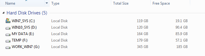

PhilChen007
Hi Stan.
1, Disk space info as following, and my installed memory(RAM) is 8GB,   is it enough?
2, TMP and TEMP folders are pointing to the location as below:
3, clear all files in the local Temp folders.
You mean is to delete all files in this folders?  if this will affect my operation system?
Thanks for your help.
Phil
2,981 Views
jiri_kral
Hi Phil,
yes - you can delete all files from temp folders without affecting installed OS. Did you try download again the S32DS installer? The file itself may be corrupted.
