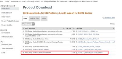

I'm trying to install S32 Design Studio v3.4 so here are the steps I took:
  • I downloaded the installation file (S32DS.3.4_b201217_win32.x86_64.exe) from here: s32kv3.4-download.JPG

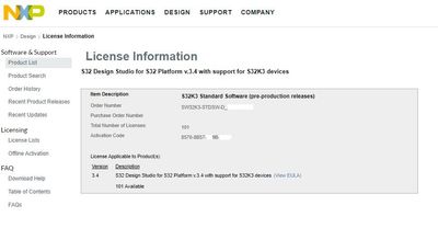

  • Here is license information from the License Keys tabs32kv3.4-download-licence_edited.jpg

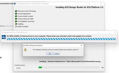

  • When I enter activation code listed above I get this error messageerror msg.jpg

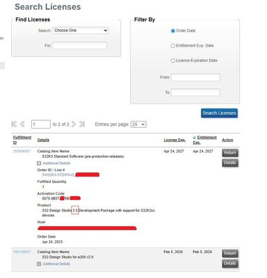

 Here is print screen from my NXP account where the same Activation code is listed but it says it's for S32 Design Studio 3.5 Development Package.(???) I didn't download or install version 3.5 at all.

I think you aren't looking in the correct place. There are actually 3 activation codes attached to your account.
One for S32DS 3.4, ends with '5C61'
One for S32K3 Standard Software, ends with 'F43B'
One for S32DS for PA, ends with '39FE'
I'll send you a PM with the full code for the S32DS 3.4 activation code. It appears you just got this one today, which means you probably also received an email with this code as well.

Since you already have S32DS 3.4 downloaded and installed, it is not necessary to download again. Please click on the 'License Keys' tab to locate the activation code.
The activation code you were tryng to use, which is associated with 'S32K3 Standard Software', is a different license which can be used for multiple versions of S32DS. However, it can only migrate to newer versions, not backward. Somehow, this license was attached to the S32DS 3.5 version, so you cannot use it for S32DS 3.4.
