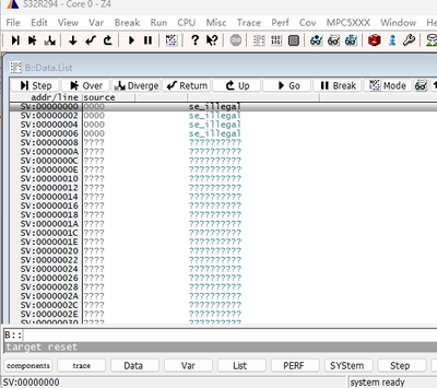

1. Using Lauterbach to burn code into the board, but after powering on and restarting, the code actually runs the program that was previously burned. If do not restart, i can still debug normally.
2. Another problem is that after the Lauterbach cpu is reset, the boot address remains 0x00000000. Do you know if the S32r has a setting like tricore bmhd?
93 Views
rweiss
Contributor V
Try this:
SYStem.Option ResBreak OFF
SYStem.Up
Reinhard
