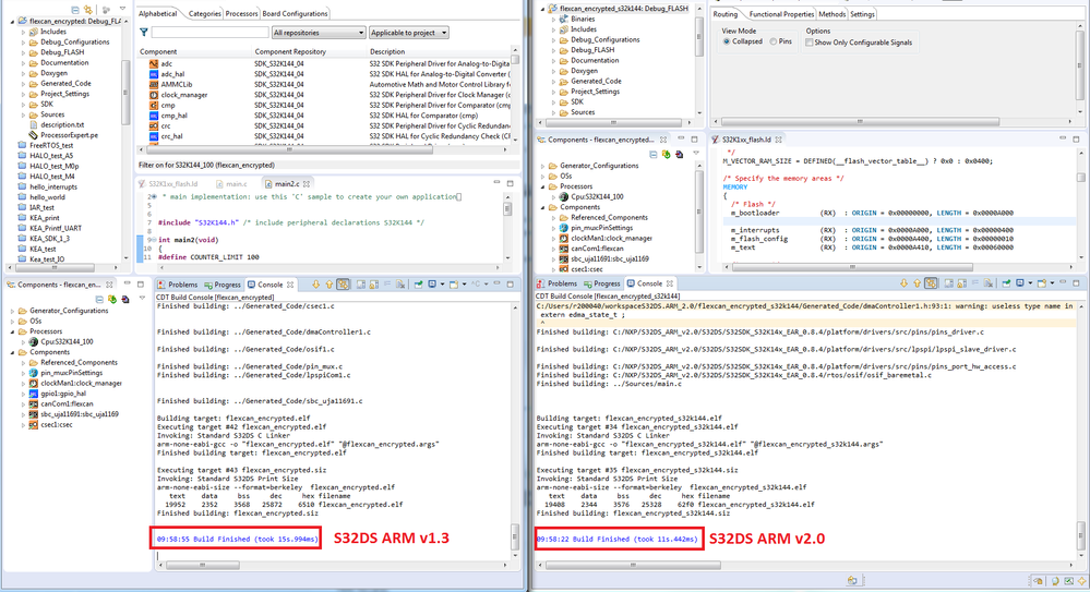

I've just made a quick comparison  v1.3 vs. v2.0 + Update 1 and S32DS ARM v2.0 build time is faster so I see completely opposite results:
Hello Example:
FlexCAN encrypted SDK example:
Actually the build speed comparison is part of our test suite before release.
