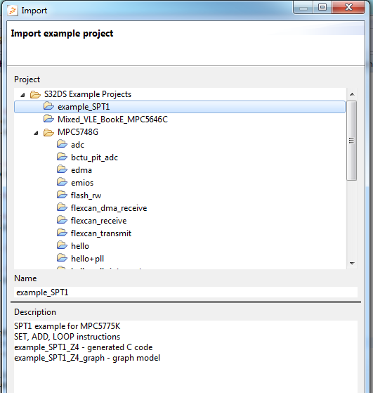

Is there any startup guide that takes you through developing a small program for SPT (signal processing toolbox). I am actually using S32DS but I assume it will be similar.

Hi Alice,I am using S32D247 processor and S32DS development environment. Data comes from external ADC via the MIPI interface. However if you have examples and a "Getting Started/User Guide" document that uses data from the internal ADC still OK. any document or example that shows how to use the graph tool and integrate it with your C/C++ code will be welcome.

I answered your question in the following thread: SPT tool fails to install
This is the only one document, which is available for SPT graphical tool. About SPT toolkit which is available on NXP website (SPT toolkit for MPC5775K|NXP ), we have only documents and examples which are part of installation.
Unfortunately the whole SPT module which is part of MPC5775K or S32R is too complex and customer are supported by their FAE's.

Martin,Ideally what I would like to see is a project with a simple c program that uses the SPT to do a FFT on a 32 values array and then calculates the local maximums. Everything you have to do in the graph part,The c code (should be minimal)Every think you have to do as config in various files.

There is an example available in the S32DS for Power. It's for MPC577K (SPT1.0) Graph Tools so you can start from here at least.
Also there is a Graph Tool documentation which might help you:
<S32_Power_v1.1>\S32DS\help\pdf\s32ds.pwr.win.gt_reference_manual.pdf

unfortunately, we do not have any example project for SPT module so I cannot provide you any one. As I wrote in my previous post, SPT is supported directly by customer's FAEs.
