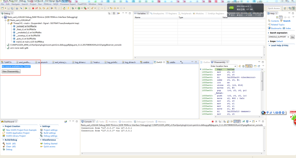

 hello
      i use printf  by FLEXIO UART  the error is
        how to slove it.
         best regards
889 Views
jiri_kral
it looks like that you don't have implemented correctly callbacks for printf function. You can look at this example - https://community.nxp.com/docs/DOC-335240  for inspiration. The difference is only in the physical device - UART instad FlexIO.
