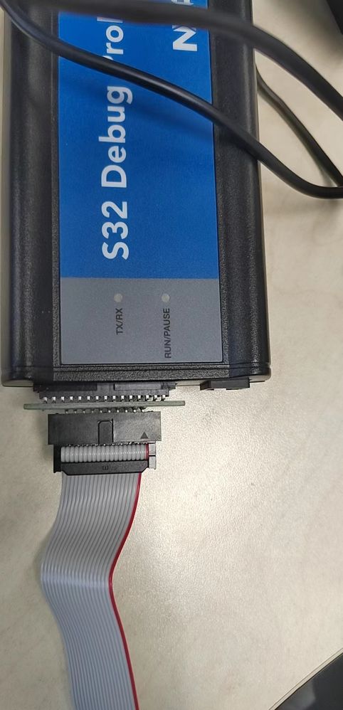

     I have bought a S32 Debug Probe ,but I can't conenect to the s32G evb boad. When I borrow a new JTAG20 board like this .I can connect to the S32G board.
   So it must be a damge board: id 700-27318 REV A.How to repaire it?Can you provide the schematic diagram? Or send one of these adapters separately,thank you!
1,153 Views
1004755883

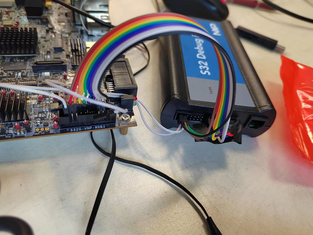

Thank you,The run/pause  light does't light,The pin30 and pin29 doesn't connect any pin.
I try to connect pin30 an pin 29 to boad VCC,it always light,but can't connect to board.
So I want to find the 20pin to 30pin conennt

Make sure the S32 Debug Probe probe is receiving power. See LEDs on S32 Debug Probe topic for a description of the status LEDs. https://www.nxp.com/docs/en/user-guide/S32DBGUG.pdf#%5B%7B%22num%22%3A56%2C%22gen%22%3A0%7D%2C%7B%22...
Make sure the S32 Debug Probe is running the OS software. For more information on loading the OS software, see
https://www.nxp.com/docs/en/user-guide/S32DBGUG.pdf#%5B%7B%22num%22%3A101%2C%22gen%22%3A0%7D%2C%7B%2...
