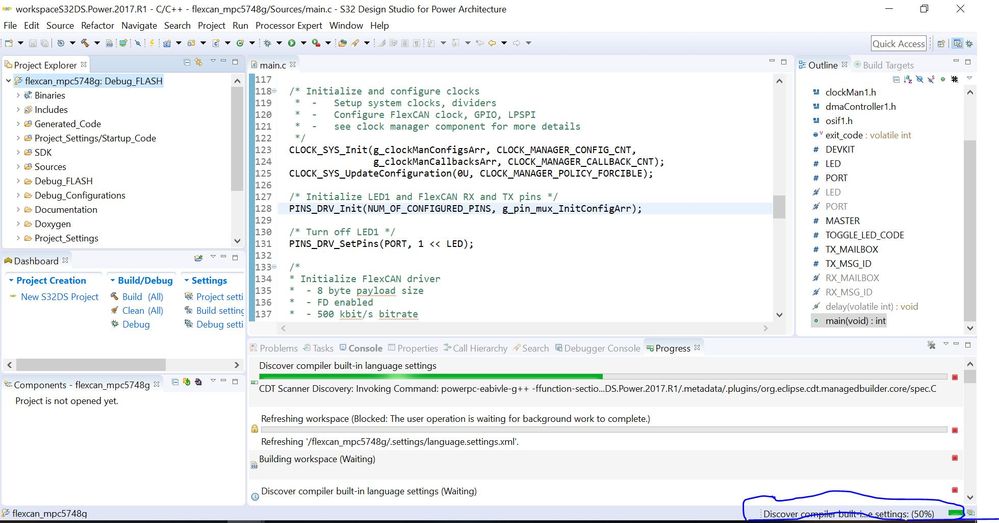

I'm using MPC5748G for dev. The supported IDE is S32 DS for power architecture.
I've installed the latest ver (2017.R1) of S32 DS power architecture with all updates, but the problem is the IDE is too slow.
when i select clean/build a project it takes around 30 min to complete it..
Any reason for this ?

We have seen some similar issues on another tool. Please see Build time is very high with S32DS for ARM V2.0 , and https://community.nxp.com/thread/460814 . It seems the root cause is not yet known, but perhaps the workaround will work for you. Try to disconnect your PC from the network and then build.

Mike,
Yes, that work around (disconnecting network) seems working fine.
