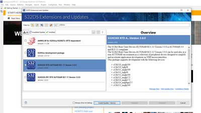

I have installed the S32 design studio v 3.5 to work with SK32K312 microcontroller and need to install the extension/update of S32k3xx RTC v3.0.0

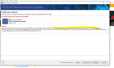

The installation seems to proceed but it is not successful the Reason shown is that there is a missing requirement, but I don't know how to get that requirement.

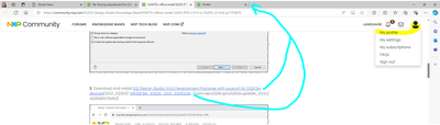

Thank you for the support, using the 1st comment link (instructions) and the last comment link (files to download) I managed to complete the installation of the set up required.

Please offline install it by refer to HOWTO: offline install S32K3 RTD 3.0.0 in S32DS v3.5

Hi, thanks for the answer I followed the instructions but in step 3 clicking in any of it links redirects me to my NXP profile. Any other way to download the S32k3xx RTD extension?

Robin_Shen
You must be logged into your account on NXP.com to gain access to the download link.

mnmurill
Hi, thank you for your answer. I am logged (see figure below) but when I click on the links of step 3 it redirects me to my profile page in nxp.

Robin_Shen
S32K3 Standard Software -> Automotive SW - S32K3 - S32 Design Studio
