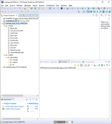

Thanks for your feedback. We were referring to the LLCE examples provided when the LLCE package is installed, as shown in the image below:
Another possibility is to verify one of the RTD examples that are available under Tresos, to confirm if there is any issue on regards of the installation.
Please, let us know.

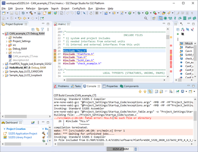

I also tried creating a new project from the S32DS AUTOSAR RTD example (CAN_example_CT)
Even this one does not build without errors
H.E.L.P !!!

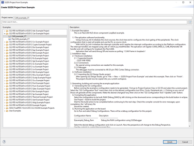

Creating the same example project from the
S32_RTD_AUTOSAR_ 4.4 D2203 Example projects

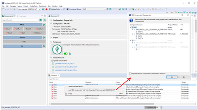

results in a project which i also have to add SDK component for each 'error' one
but at least it eventually being built OK
Doing the same add SDK component for the same example but from the S32_RTD_AUTOSAR_ 4.4 D2203  - does nothing and the error are not resolved !

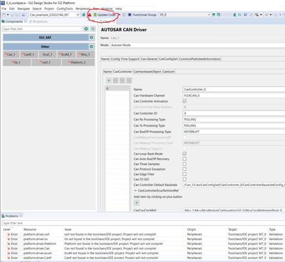

We may have misunderstand this last comment. The "error" you are seeing under the Config Tools is related to not generating the code. If we import an RTD example then open the same view, we will see a similar/same scenario than the one you are seeing, image below:

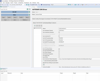

Once we click the "Update Code" button (circled in red on the previous image), we will stop seeing this "error":
This should be documented under the steps provided inside the "description.txt" file attached to each example project.
As for the previous "errors" you are mentioning, this step seems to be missing, which is to generate the code from Config Tools. All examples under the RTD/LLCE should be out-of-the-box. Emphasis in should be, since there are known issues under RTD v3.0.2 and LLCE v1.0.4 documented in this community.
