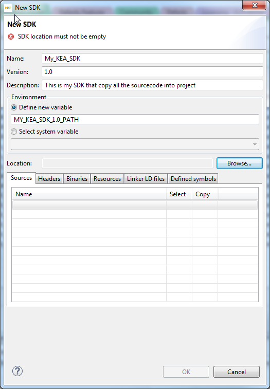

I am using the S32 KEAZ128 SDK in my project. By default, all the SDK files are linked to my project. Because multiple project are to use the SDK and make specific tweaks for each application, It necessitate the SDK files are copied into each project rather to be linked into. Is there any way to do it? Thanks, Jerry

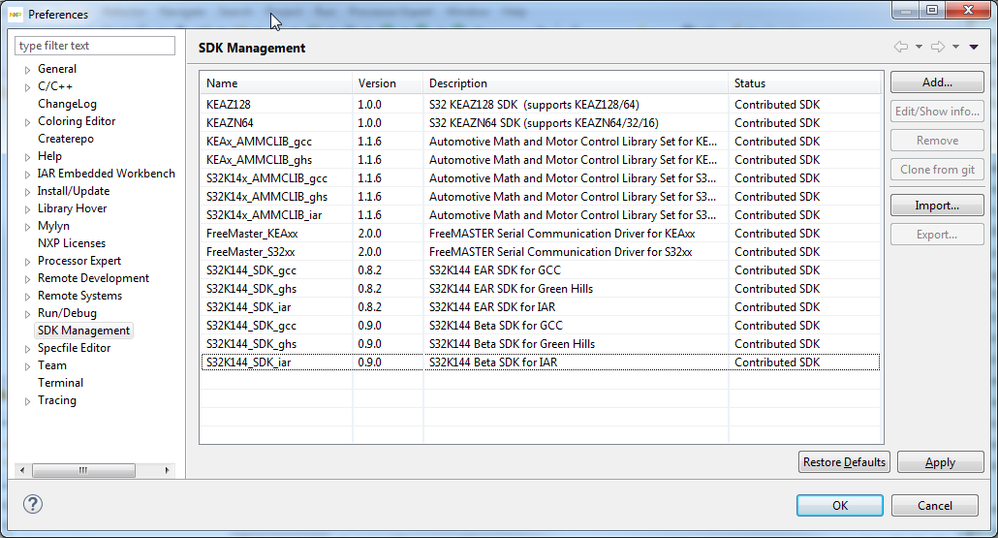

1) go to SDK Management dialog (menu Window -> Preferences -> SDK Management)
2) Click "Add..." to create a new SDK and enter Name, Version, Description

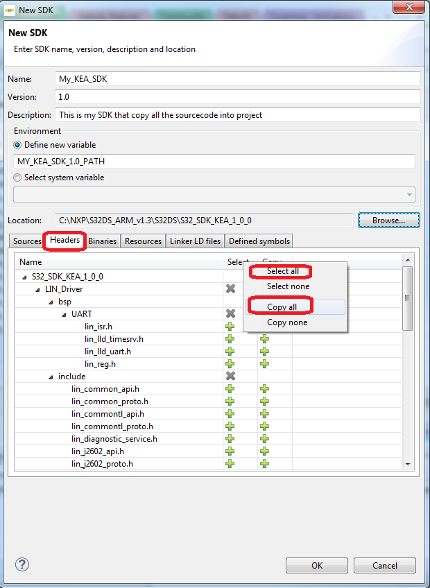

3) Browse to select SDK source path ("c:\NXP\S32DS_ARM_v1.3\S32DS\S32_SDK_KEA_1_0_0")
4) Select all / Copy all the sources and headers

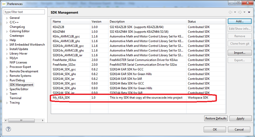

5) Now your workspace contains a new SDK

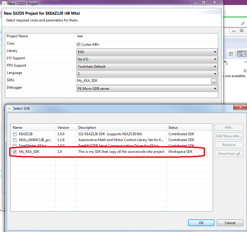

6) You can create a new project now and your new SDK should be available in the list of SDKs so select it and finish the wizard.

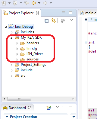

Your project should now contain a copy of entire source folder structure (+ include paths):

3,193 Views
jianyingchu
Hi Stanislav,
appreciate your reply very much. your solutions works great to me! BRs, Jerry
