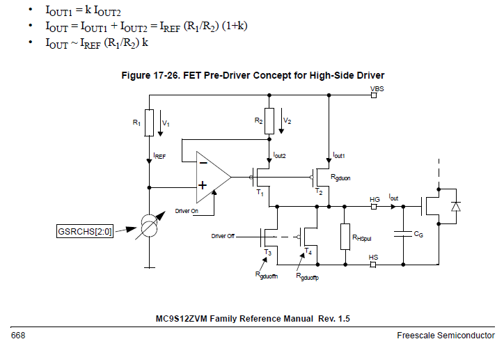

S12ZVM has the function the slew rate control of high side gate driving, GSRCHS,
and the range is as below,
Iref(min)=10uA -> Iout = 10u * 36 * 450 = 162mA
Iref(max)=80uA -> Iout = 80u * 36 * 450 = 1.29A
If we would like to reduce the current further than 162mA, is there any good idea?

Looking at the concept of the FET Pre-Driver in the S12ZVM ref. manual, a way to decrease Iref and Iout is to decrease voltage on VBS. But, this can lead to some other consequences.
Another way is to put a resistor on HG pin (and power FET's gate). With this approach the max Iout current will be decreased as well.

iggi-san,
Thank you for your response.
To decrease voltage on VBS would not be good for the BLDC stable rotation,
so I understand that the only way is to put a resistor on HG pin and there is no way to reduce the gate drive current by itself.
