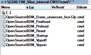

- Option (Target, for example HC12Multilink CyclonePro)->Command Files
    My cmd directory in application

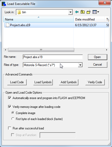

- Option File->Load Application
                 Load Code-loads the code only
