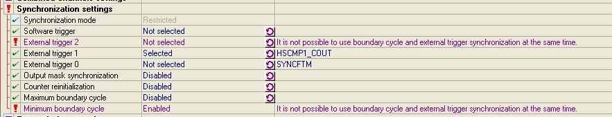

Using CW 6.3 for S08 (processor expert 3.09) configuration S08MP16, used to drive the BLDC, set PWMC synchronization settings , the figure error , I ask , where is the problem ? How should I set up to achieve PWMC synchronized with the analog comparator .

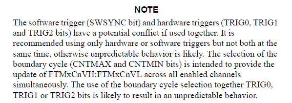

The conflict is generated by simultaneous usage of software trigger and hardware triggers. The S08MP16 Reference Manual contains this note:
Software trigger is automatically enabled because it is used by the Load method of the PWMMC component. If you need to use external trigger you should disable the generation of the Load method in the PWMMC component. This will solve the conflict.

Synchronization software trigger is used by the method Load of PWMMC component, which must be called after using SetPeriod, SetDuty or other methods (as described in the component documentation) to apply the new settings.
