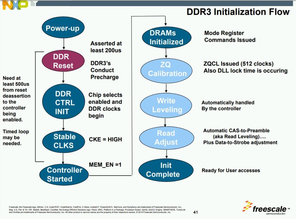

This is what a want to do:
1) Initialize DDR controller with no ECC and no init memory..
lis r7, 0x43000008@ha
ori r7, r7, 0x43000008@l
stw r7, DDR_SDRAM_CFG(r6)
lis r7, 0x04400000@ha
ori r7, r7, 0x04400000@l
stw r7, DDR_SDRAM_CFG_2(r6)
lis r7, 0xC3000008@ha
ori r7, r7, 0xC3000008@l
2) Just After the initializacion, i want to check ram and reinitialize de DDR controler witch ECC and memory initialization. I'm trying this for the reinitialization:
lis r7, 0xC300000A@ha
ori r7, r7, 0xC300000A@l
lis r7, 0x4300000A@ha
ori r7, r7, 0x4300000A@l
lis r7, 0x6300000A@ha
ori r7, r7, 0x6300000A@l
lis r7, 0x04400010@ha
ori r7, r7, 0x04400010@l
lis r7, 0xE300000A@ha
ori r7, r7, 0xE300000A@l
lis r7, 0xE3000008@ha
ori r7, r7, 0xE3000008@l
Sometimes it works fine and other times it hangs saying that the memory is nos available.
Thank you in advance.

r8070z
From the DDR3 initialization flow we see that MEM_EN bit starts DDR3 device full initialization which supposed that  DDR3 device has been reset. I think your experiment confirms that. Re-initialization should starts from the DDR3 Reset.
