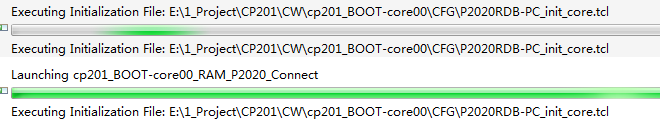

   When i used Jtag to dubug,but the PPC cannot stop the Chip and show as text。I need your help to debug this problem,Thanks!!!

Hello  Lu Yingyu,
Would you please refer to the following procedure to capture CCS log to me to do more investigation.
Before connect to the target, please enable CCS log from "Run->Debug Configurations-><project>-core00_RAM_T2080_Download->Edit...->Advanced->Advanced CCS setting->Enable logging", and connect to the target from "Run->Debug Configurations-><project>-core00_RAM_T2080_Download->Debug", the CCS log will be printed in the console panel in CodeWarrior IDE.
Note: Please open the console panel from Window->Show View->Console, and if nothing displayed, please choose the correct session on the right top icon in the panel.If the CCS log in the console is truncated, please enlarge the console buffer from Window->Preferences->Run/Debug->Console->uncheck "Limit console output".

Thanks,there are some message in Console。Is this what you want?If not Enough i will send you a text include all the detail。
