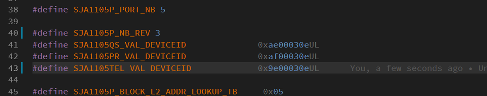

   i found  the driver support device  is sja1105QS and sja1105PR
   but my device is sja1105EL
   so i add my device id in driver code

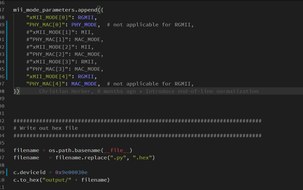

and then i found the platform_independent dir can use python to generate the firmware.bin

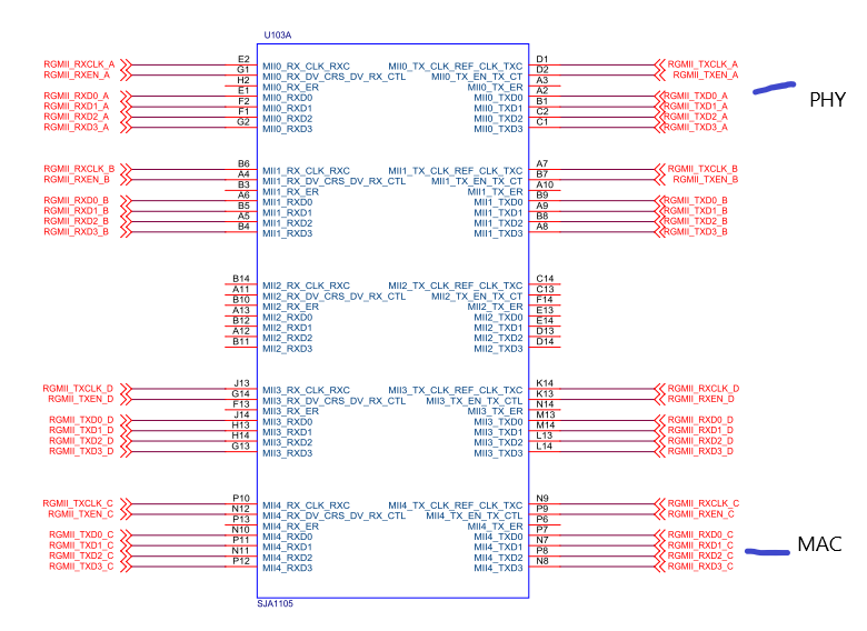

our hardware design is the port 0 connect to phy and port 4 connect to soc mac
so i modify the cfg_applicationBoard.py
but the console just display
i will try my best to debug it
if u see this problem , please help me
thanks a lot

bpe
The driver you are trying to utilize is _not_ valid for SJA1105EL.
Merely correcting the device IDs is not sufficient because SJA1105EL/TEL
and SJA1105P/Q/R/S are not software compatible.
Platon
