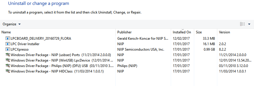

Installed program list shows (filtered for NXP)

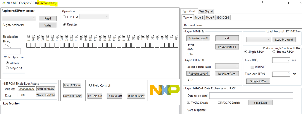

NFC Cockpit show "Disconnected"...

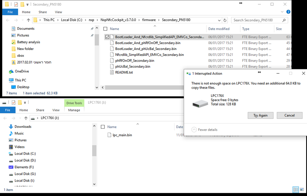

I also tried to re-program the board by momentarily shorting SW200 when powering the board.
However I got an error message when dragging-and-dropping bin file on the mass storage device (should I keep SW200 shorted after power up in order to copy ?)
