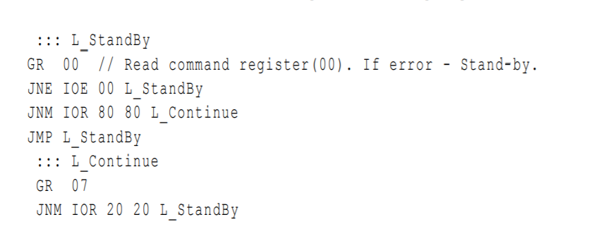

 I have doubt when use the function of RC6303 LPCD mode.As shown below,can you help me translate these few lines of assembly code into C language, I can't understand the assembly.Thanks!

I am sorry, but is the assembly code released by NXP? I need to find where it is from to get the right person to check it. Please kindly clarify.

Hello, NXP did not release the assembly code, but instead saw it in the application note AN11145 they released.

Hi Binshen,
It is not assembly code, it is a script file for CLRC663 red board, for the related C file, there is an example , please refer to RC52xPcSerial Command explanation for details.
