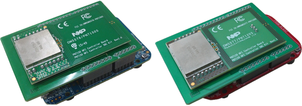

Hello NFC community:
NXP released the new PN7150 NFC Controller chip with enhanced power output, and there is also the new Arduino compatible demokit OM5578/PN7150ARD. See more information in the next pages:
PN7150: High performance full NFC Forum-compliant controlle|NXP
OM5578/PN7150ARD: Demoboards for PN7150|NXP
There is also a new PN7120 SBC kit for arduino:
http://cache.nxp.com/documents/user_manual/UM11008.pdf
Due to the Arduino interface pinout, these kits can also be used with Kinetis Freedom Boards. The target of this document is to create projects to use the NFC Controller lîbrary with the PN7120 or PN7150 together with a Kinetis host. Also you will find example projects created for the FRDM-K64F and FRDM-KL43Z.

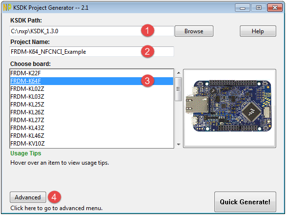

1) Open the KSDK project generator.
2) Enter the KSDK v1.3 installation path, give a name to the project, select your Freedom board and click on "Advanced":

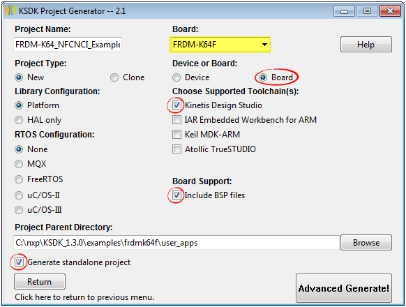

3) In the advanced settings window enable the checkboxes for:
- Include BSP files
- Generate standalone project
- Kinetis Design Studio toolchain
- Board (confirm that your board is shown in the drop-down menu)
NOTE: The path for the newly created project is set by default inside of the KSDK v1.3 installation. For a standalone project you can change the location, just remember such path to import the project to KDS workspace in a later step.
Leave the rest of configurations as default (New project, Platform library, no RTOS) and finally click on "Advanced Generate!".

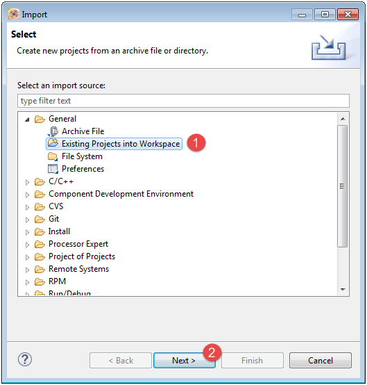

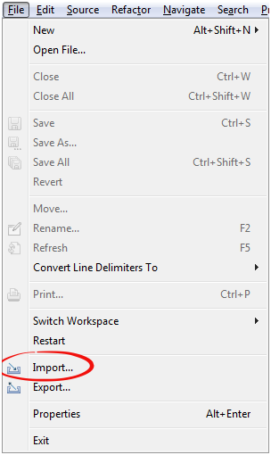

4) From Kinetis Design Studio go to File -> Import.
5) Go to General -> Existing Projects into workspace and click "Next".

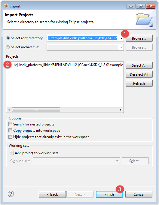

6) In "select root directory" browse to the location of the platform lib for the created project. By default this path would be:
C:\nxp\KSDK_1.3.0\examples\frdmk64f\user_apps\<project_name>\lib\ksdk_platform_lib\kds\<MCU>
<project_name>: The name given initially to the project.
<MCU>: The corresponding device number (K64F12 in this case).
Make sure that the project check box is enabled and click on "Finish".

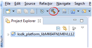

7) Select the KSDK platform library project and click on the "Hammer icon" to build it.
Repeat steps 4 through 6, but this time browse to the location of the application project. In this example the path is:

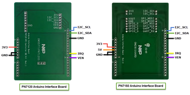

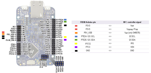

- The Arduino Interface Boards use the next pinout for communication between the OM5578/PN7150 or OM5577/PN7120 kits with the Freedom or Arduino boards:
As shown in the picture, the pinouts are similar except for the 5V connection. This leverages the enhanced output power feature of the PN7150 NFC Controller.
- We need to check the corresponding pins that will be used from the Freedom board. In this case, the connections to the FRDM-K64F board would be as next:
IMPORTANT: The pinout shown below corresponds to Rev E3 schematics of FRDM-K64F. For Rev D1 the pin used for IRQ (header location J2[2]) must be PTA0 instead of PTC12.

2) In the file gpio_pins.h add 2 extra elements to the gpio enumeration. Also add extern declarations for the 2 pins defined in the previous step.
NOTE: For FRDM-K64F the pins are PTC12 and PTC3. Select corresponding pins for your Freedom board.

3) In the file pin_mux.c define a function to configure the MUX setting of the required GPIO and I2C pins to interface with the NFC Controller.
void configure_nfcc_pins(void)
  /** I2C_SDA **/
  PORT_HAL_SetMuxMode(PORTE,25u,kPortMuxAlt5);
  PORT_HAL_SetOpenDrainCmd(PORTE,25u,true);
  /** I2C_SCL **/
  PORT_HAL_SetMuxMode(PORTE,24u,kPortMuxAlt5);
  PORT_HAL_SetOpenDrainCmd(PORTE,24u,true);
  /* NFCC IRQ */
  PORT_HAL_SetMuxMode(PORTC,12u,kPortMuxAsGpio);
  /* NFCC VEN */
  PORT_HAL_SetMuxMode(PORTC,3u,kPortMuxAsGpio);
NOTES:
- Check the corresponding pins on your Freedom board. FRDM-K64F uses PTC12/PTC3 as GPIOs while PTE24/PTE25 are configured as I2C pins. For I2C pins also check the MUX number in the device's Reference Manual (e.g. PTE24/PTE25 in K64F have the I2C function in ALT5).
- This function needs to be called from your project to configure the required pins. e.g. from hardware_init().
- Some Freedom boards share the I2C pins of the Arduino compatible header with an on-board I2C device (e.g. accelerometer), with SDA/SCL pull-up resistors populated already. If this is not the case for your board, make sure to place external pull-ups to  MCU VDD or enable the internal pull-ups as temporary workaround.

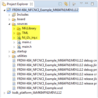

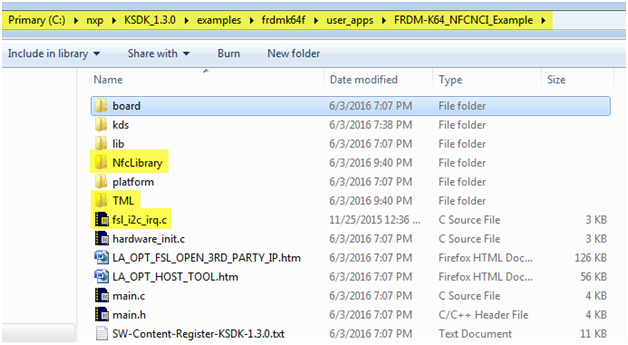

5) Copy the folders NfcLibrary and TML to the project folder. The file fsl_i2c_irq.c is also required. In this case the file is found in the next path:
C:\nxp\KSDK_1.3.0\examples\frdmk64f\user_apps\<project_name>\platform\drivers\src\i2c
NOTE: If the project was not created in standalone mode, just search the fsl_i2c_irq.c file from your KSDK installation.

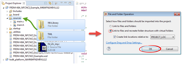

6) Add the NfcLibrary and TML folders with all its subfolders and files to the project's tree, so the lilbrary is part of the build. Also add the file fsl_i2c_irq.c to the project. In KDS you can drag and drop folders and files to the project explorer view.

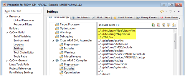

7) Add the compiler include paths for the inc folders.

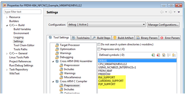

From the KDS preprocessor settings add or remove the next conditional compilation macros according to your functional requirements:
CARDEMU_SUPPORT: The NFC Controler host (MCU) can emulate a contactless card which can be accessed by an external Reader/Writer.
P2P_SUPPORT: The host MCU can establish a 2-way communication accesing to or sending data to an external Reader/Writer.
RW_SUPPORT: With this mode the host can access a remote contactless tag/card via the NFC Controller.
NCI-DEBUG: If defined, all information transferred between the host MCU and the NFC Controller Interface (commands, responses, notifications, data) is echoed to console for debug purposes.

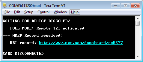

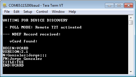

RW mode:
- Placing a tag with a single text, URI or vCard NDEF record next to the NFC reader antenna. Examples:

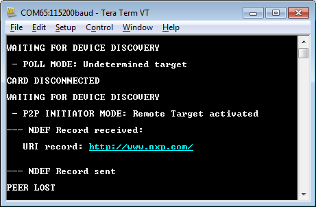

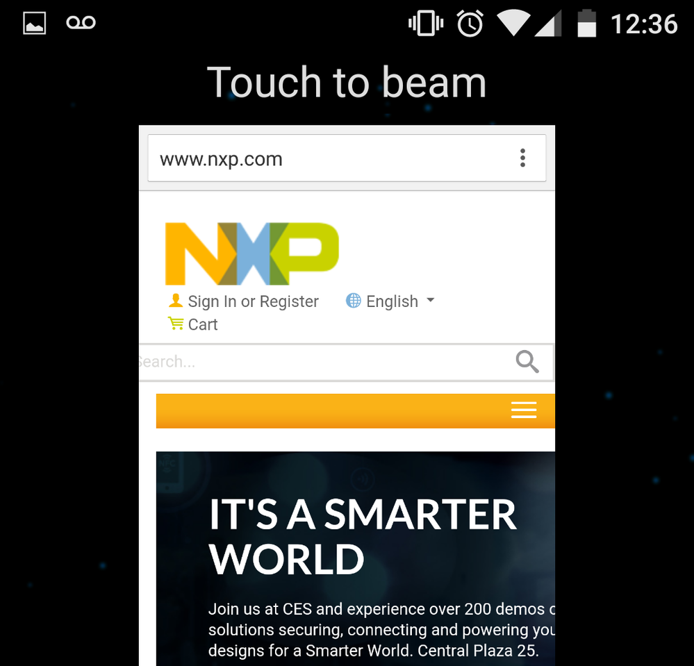

P2P mode:
- Bring an android phone with NFC enabled close to the NFC controller antenna and use the "beaming" feature. In the case below the NXP home page is "beamed" from the adroid phone's explorer. After this, the NFC enabled phone will receive the "Test" NDEF record.

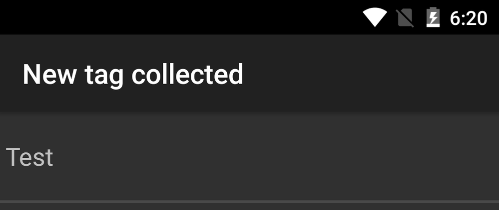

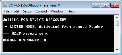

CARD EMULATION mode
  For this mode it is required to remove the P2P_SUPPORT macro and rebuild/reprogram the project.
- Bringing an android phone set to read a NFC tag close to the NFC controller board. The NFC enabled phone will detecta T4T tag type with the "Test" NDEF record.
