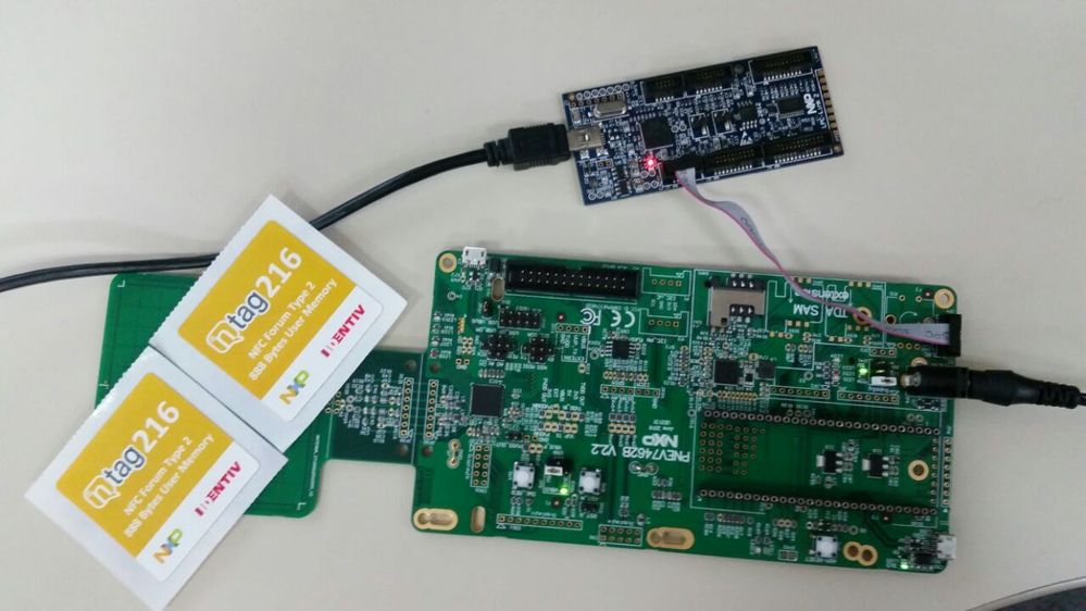

The purpose of this document is to demonstrate the activation of each tag at a given index.
This demonstration is going to be made with two NTAG 216.
This demonstration is based on NXP NFC Reader Library v05.02.00, NfcrdlibEx3_NFCForum project for PNEV7462B, in which some modifications are going to be made in order to carry this out. These tags are compliant with NFC Forum Type 2 Tag and ISO/IEC14443 Type A specifications.

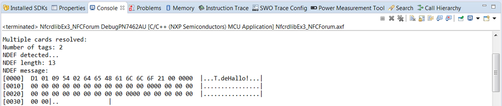

The demonstration will be as simple as activating one tag, read its NDEF message, activate the second tag and read its NDEF message as well so that we make sure the activation process is performed correctly.
Each tag was previously written with a text NDEF message respectively.
Tag 1:
Text: Hallo!
Language: de

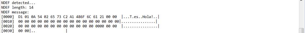

Tag 2:
Text: ¡Hola!
Language: es

 status = phalTop_CheckNdef(palTop, &bTagState1);
/* Read NDEF message */
status = ReadNdefMessage(PHAL_TOP_TAG_TYPE_T2T_TAG);
 DEBUG_ERROR_PRINT(status);
Behavior shown in the console monitor:
NFC Forum Example:
This implementation demonstrated the activation of two type A tags at a given index.
