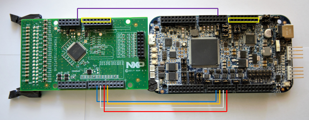

I have MPC5744P DEV_KIT and MC33771 SPI DEV_KIT and I want to connect& operate both of them together. I can see that MC33771 MBD toolbox is given under S32K1 tool.(By the way, creating BMS MBD is a great idea. I believe that will give you great oppurtunity , us great flexibility and shorter development time. SPECIAL THANKS FOR THAT).
I wonder whether can I use BMS MBD tools with MPC5744 directly by connecting by SPI.
I have shared a sample model at the attachment and a figure depicts the model.
Do I need to configure sth else?

As I promised, I've attached the MC33771B and MPC5744P Simulink project using custom code. So, as you can see in this picture, additional connections have to be performed between boards. Exactly the same mount as for 32K, the BMS J9 [2-16] have to be connected to J3 [1-15] on the MPC5744p REV E. board.
Unfortunately, I had to use the DPSI1 for communication (PA8, PA7, PA6, PA5) but I think the previous image shows exactly how to perform all the connections. I was not able to get a response on the MISO/SIN DSPI0 which pins are already connected to the BMS board, probably because of the level shifter connected.  For now, this wiring works great.

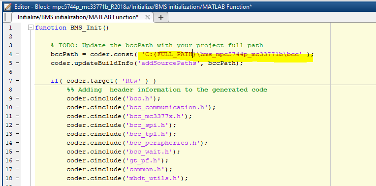

So, the steps to run this are the following:
1. Download the archive, and open the model in R2018a or newer version.
2. Go to Initialize and open the BMS_Init function and update the location of the bcc folder
3. Open the config block and update the COM port of the MPC5744P.
4. Run the model and deploy it on the target.
5. Open the FreeMaster project attached, update the COM port, and .elf location and connect to the board. You should be able to see all the variables converted.
