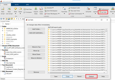

1. Are there any MBDT toolboxes (perhaps for other hardware platforms) that you have installed? In this case, I would recommend to you to remove them from the Matlab path, and keep only the MBDT for S32K3. You could do this by setting the Matlab path to its default state (as illustrated below).
Then, add the MBDT for S32K3 to the path by running the mbd_s32k3_path.m found in the toolbox root.

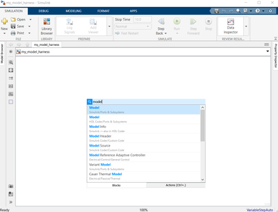

2. If the problem is not related to the model, but appears only when trying to set the target for the test harness, there is an alternative workflow that you could follow for performing a PiL simulation of your model. You can create a new model, where you could add a Model Reference block, by typing Model in the Simulink canvas, and selecting the option as highlighted below:

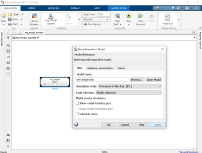

Now, by double clicking this block, you can set the model you would like to reference (the one containing your application implementation) and then choose the Simulation Mode as PiL.
Now, you can feed your model reference block with appropriate inputs for your PiL simulation and inspect the outputs returned by such a process. You could easily perform such simulations by using the SIL/PIL Manager Add-On of Simulink. For more details on this process you could check the examples we provide inside the toolbox under the S32K3_Examples/pil folder. The s32k3xx_pil_s32ct and its associated documentation s32k3xx_pil_harness_s32ct_example_readme.html could be a good application to start with.

- Apparently, whenever I load my application the NXP MBT path is prepended by another toolbox so this was the issue. I now have script to load the application and then run the mbd_s32k3_path.m file to again successfully reset the path to NXP MBT. Then it works fine.
Thank you so much for the clarity!
