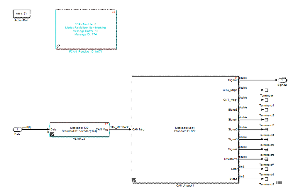

I am building off of the FlexCAN Traffic example in the MBDT to create a model that receives multiple CAN messages.  I am using a method very similar to what Razvan just happened to post here.
However, I am also trying to use the Simulink Vehicle Network Toolbox to unpack the data in the CAN messages into usable signals using a .dbc file.
In some scenarios I am getting a build error indicating that stack and heap are overlapping.  Some scenarios:
  • Single CAN message RX with multiple signals being unpacked - builds ok
  • Two CAN message RX with a single signal being unpacked from each message - builds ok
  • Two CAN message RX with one signal being unpacked from one message and multiple signals being unpacked from the other message - build fails with error
If I don't use the Vehicle Network Toolbox and manually unpack the data from the CAN message for multiple messages I don't seem to have a problem, although I haven't tried that extensively yet.
Examples of each of the above scenarios are attached, along with a build log showing the error I get in the third scenario.  Can someone offer some insight as to what is causing the stack/heap issue and how to avoid it when using the vehicle network toolbox for CAN message unpacking?

From what I can see, the problem is that you run out of memory. Let me go into a few details regarding our linker file:
At the top you can find the heap and stack sizes defined:
HEAP_SIZE = DEFINED(__heap_size__) ? __heap_size__ : 0x00000400;
STACK_SIZE = DEFINED(__stack_size__) ? __stack_size__ : 0x00000400;
After those, you can find the memory areas defined (in bold what's important to your issue):
/* Specify the memory areas */
MEMORY
/* Flash */
m_interrupts (RX) : ORIGIN = 0x00000000, LENGTH = 0x00000400
m_flash_config (RX) : ORIGIN = 0x00000400, LENGTH = 0x00000010
m_text (RX) : ORIGIN = 0x00000410, LENGTH = 0x0003FBF0
/* SRAM_L */
m_data (RW) : ORIGIN = 0x1FFFE000, LENGTH = 0x00002000
/* SRAM_U */
m_data_2 (RW) : ORIGIN = 0x20000000, LENGTH = 0x00001000
If we go further, we can see that m_data_2 is comprised of the following:
  • customSectionBlock
  • bss
  • heap
  • stack
The first 3 sections are placed one after the other in memory, while the stack is placed staring from the end of m_data_2.
At the end we have the following assert
ASSERT(__StackLimit >= __HeapLimit, "region m_data_2 overflowed with stack and heap")
where we check that stack and heap don't overflow. In your case the bss gets so big that pushes the heap over the stack. To bypass this, you can change the HEAP_SIZE or STACK_SIZE, but that depends on what you are looking for. When you're not using that toolbox, the bss is smaller and heap and stack are not overlapping.
If you want to change the heap/stack sizes, the file you'll want to edit is found here:
{ROOT_DIR}\mbdtbx_s32k14x\src\linker\gcc\S32K142_16_flash.ld
(or _32_flash.ld at the end, depending on what SRAM you have on your S32K - you can select the option from the main configuration block - MCU tab - SRAM).
I did some tests and found that your application Dual_CAN_Test_Build_Fails works with the following adjustments:
STACK_SIZE = DEFINED(__stack_size__) ? __stack_size__ : 0x000003F0;
So with just a slightly lower value for STACK SIZE, you can make it work - but when you'll make a more complex model that will put more data in the .bss you'll probably get the same error. I can not really know how it's more beneficial for you to manage the heap/stack/bss sizes.
