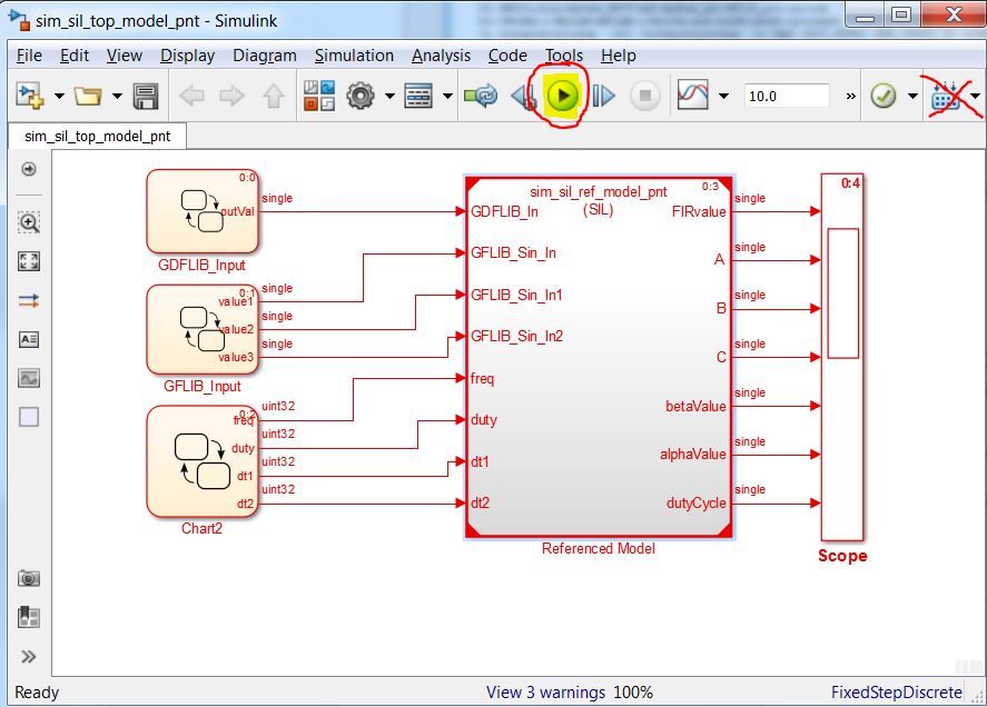

First of all - as a general thing - for SIL or PIL modelling you should click on RUN button as if you are simulation the model. You don't need to use BUILD MODEL button

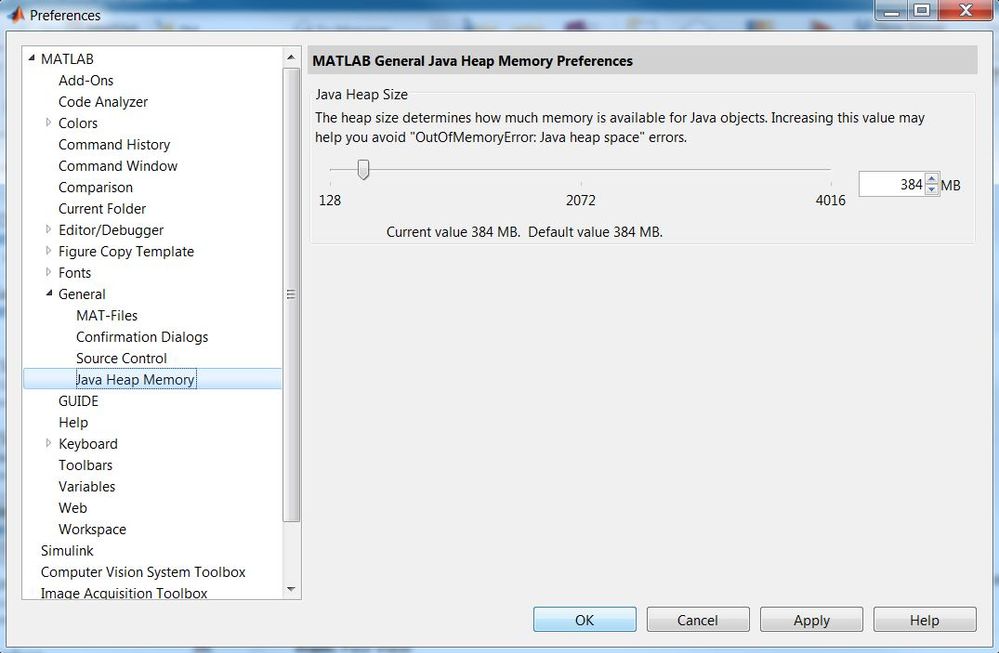

Personally, i've never faced this kind of error but i would start by increasing the memory allocated for Matlab process.

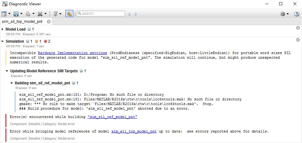

        I tested the way that you said, but it seems not work. I reinstalled MATLAB R2016a and MBD examples for MPC5744P V2.0. I only clicked the RUN button. There are two errors, and if you have experience about this?
      Thanks a lot!
      Paul Xu

Can you try to install the Matlab in a path without spaces ? Right now your installation is in D:/Program Files/MATLAB.
From your last screenshot it seems that the path is broken into 2 separate commands that do not exist hence the issues (NO SUCH FILES AND DIRECTORIES) you are having with the running the SIL and PIL
