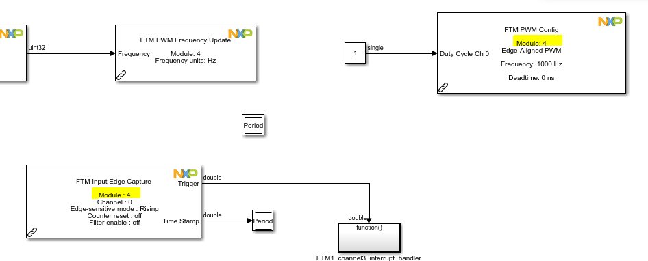

I'm using FTM blocks in my design but I can not simulate or build model when I use FTM Input Edge Capture block. Only this block give me errors. Can you please help me to solve this problem ?BeforeError.PNG
I have this errors with addition of FTM Input Edge Capture block.
Regards.

Hello utkuckmgl@gmail.com‌,
The reason that this error is caused is related to the fact that you are trying to use the same FTM module, 4 same as input and PWM generator which is not possible in hardware.
The FTM module uses the counter in a different way for PWM generation than for FTM Input Edge Capture. Please select other FTM Module for FTM Input Edge than the module 4 and look after an appropriate PIN.
Hope this helps,
Marius

Hello mariuslucianandrei‌,
Thank you for your help, it works.
