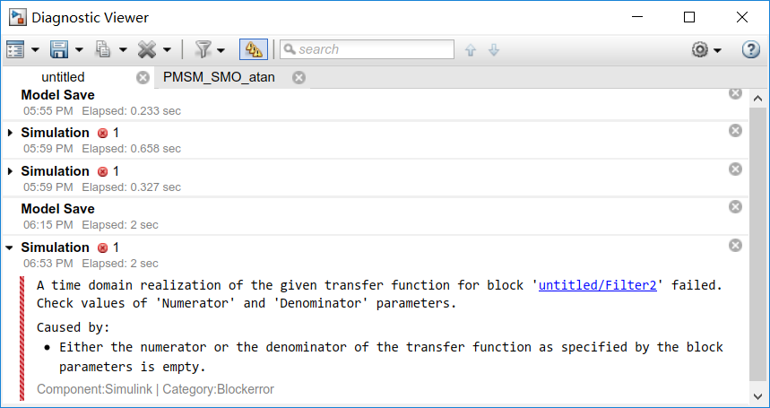

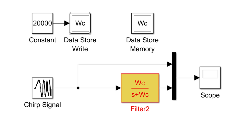

Hi Guys,

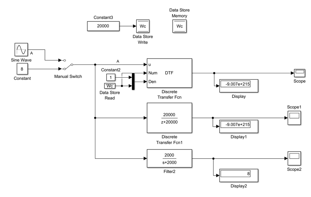

I met a question when built the simulink model.
I wanna change the munerator coefficients parameter of Transfer Fcn dynamiclly,but pop up an error,i don't know how to deal with it .
the modle is below:
pop up the error:
The attachment is the model.
Original Attachment has been moved to: Model_1.slx.zip

Daniel_Popa
Hi Eden Li,
That is a Matlab limitation for standard transfer function block that can be easily workaround via:

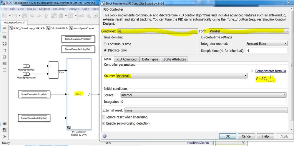

#1: mathematical approach, to create the transfer function representation via Simulink basic ADD/MULTIPLY/INTEGRATOR/DERIVATIVE blocks in which we can add DATA STORE READ inputs.

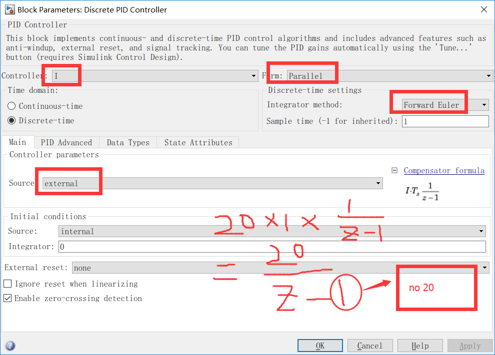

#2: mimic - reuse other blocks that allows DATA READ to mimic the functionality of standard transfer function block. One example might be PID controller block that can be easily transformed in a 1st or 2nd order transfer function, depending on the options highlighted below.
Note that these 2 approaches works for both S and Z domains
Perhaps others might know better ways. Please leave a comment below for any other approach.

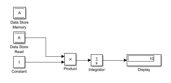

edenli
Contributor V
Hi Daniel,
I can not allocate parameter of pid module ,making the partA equal to PartB?
PID module show as below:
3,733 Views

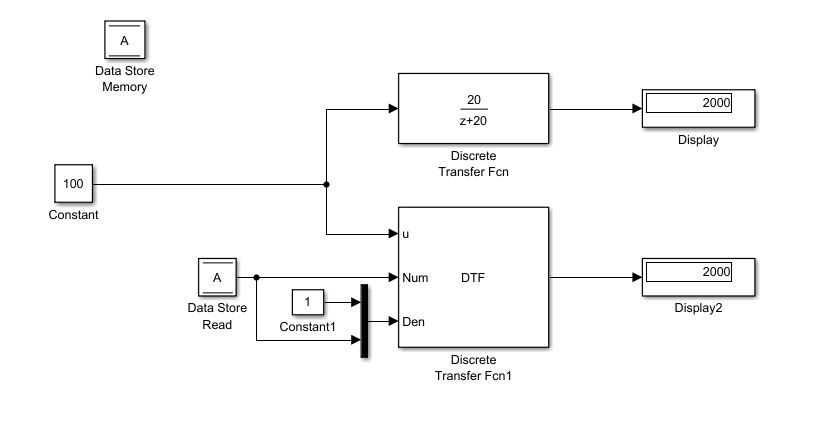

Daniel_Popa
For digital transfer function we can add the DATA READ directly because it is supported in the UI
And you'll have something like this:
For the suggestion with "mimic" you need to play a bit with the maths - since it is not straightforward like using a single block.
Here is a glace of what you can do:
Hope this helps!

Hi Daniel,
The two ways above to solve the  theme is valid,but i come across another question,the constant 8 inputs the Discrete Transfer Fcn and the  continuous Transfer Fcn at same time,but the result is great defference.i changed a lot of parameter about the Discrete Transfer Fcn ,but result is not improment.

edenli
Contributor V
Hi Daniel,
Thank you very much! you give me a hint!Now i solved the question!
