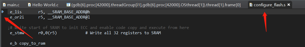

Hi,everyone.

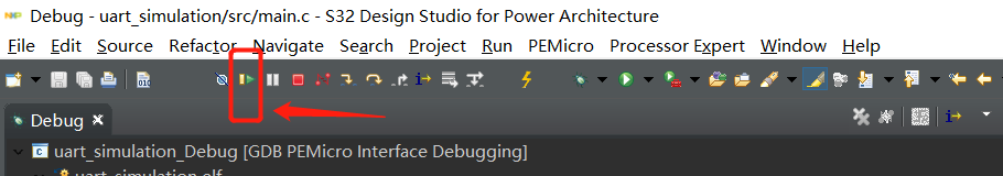

I bought a Devkit-MPC5744 recently, and downloaded the Model-based Design Toolbox for MPC5744P from the NXP website.
And then I open the example model file from the Model-based Design Toolbox. The model is "uart_model_pnt".
 After that I configure the parameter and build the model, and then the Simulink generate the C code.
After the help of NXP S32 ds community, the project could be compiled successfully.
But the problem is that the program doesn't run.

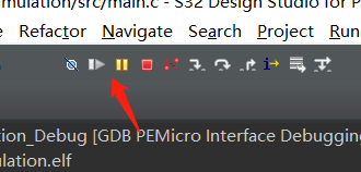

When I click "resume" button and start the program, it will stop somewhere in configure_flash.s file
And when I reclick the "resume" button, the program seems running, but actually not running.
I am sure the program are not running because I add some sentences to turn on the LED. However, it doesn't work.
 The console text and the project are in attachment.
Maybe my progress are not correct?
I would do appreciate it if you could help.

Hello 1506840872@qq.com‌,
You should try importing using the file exported by our toolbox to avoid any startup/linker/compiler issues (which I suspect to be the problem in your case). You can follow this article on how to import it to S32DS for Power (link).
Please let us know if you encounter any issues following this approach.
Kind regards,
Razvan.
