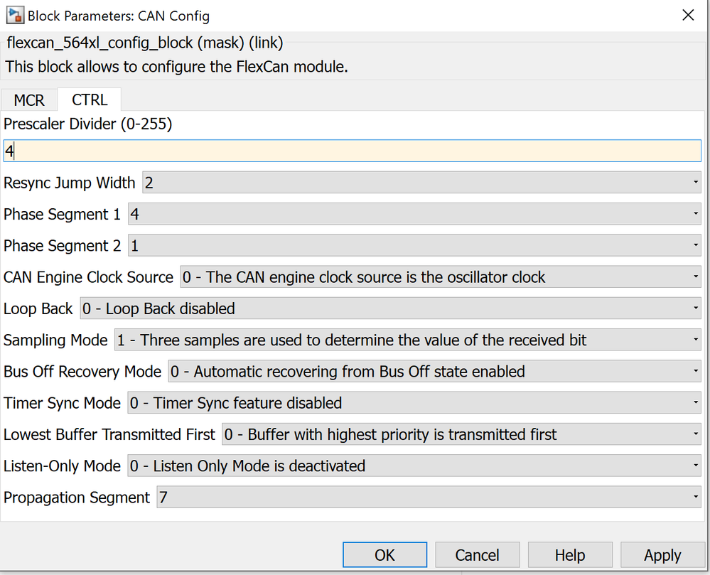

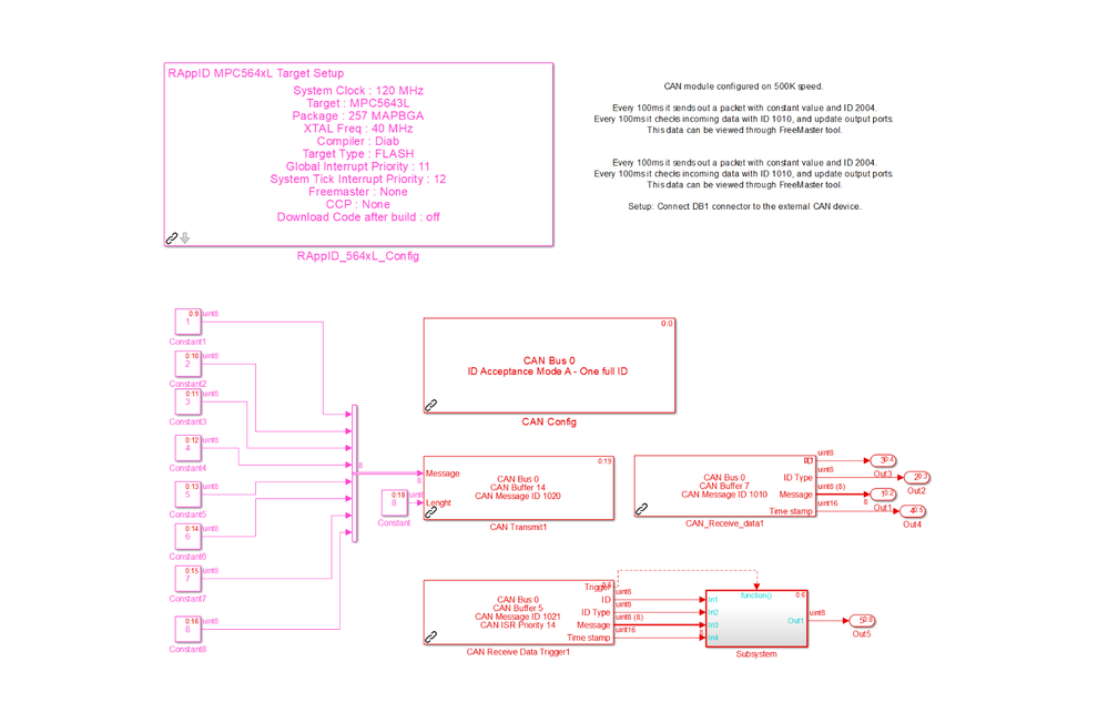

I am facing issue with CAN transmission. I am using can_simple_block Simulink example for creating the communication. I am using XPC56XL_257BGA module with XPC56XX EVB. I am connecting DB1 connector to PCAN USB Interface. But I am always getting Error Passive State. I am unable to trouleshoot the error. I have rechecked the jumper settings. Could anyone please help me in resolving the issue.
Also how to set the baud rate of CAN module?
834 Views
constantinrazva
As for setting the baud rate, in this older toolbox you have to manually set the following parameters:
  • Resync jump width
  • Phase segment 1
  • Phase segment 2
  • Propagation segment
Using these and knowing the frequency of the clock, you can calculate the baud rate. Please refer to the MPC5643L reference manual to get more in-depth information about how to calculate for this specific MCU (CAN transceiver actually).

anu_mathew
Thanks for the response. I have resolved the issue, by setting the baud rate correctly.
