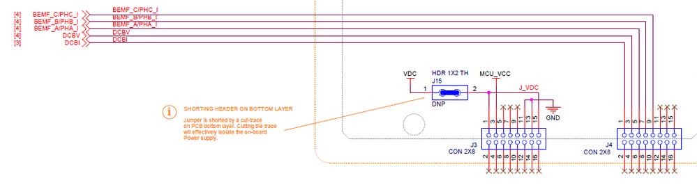

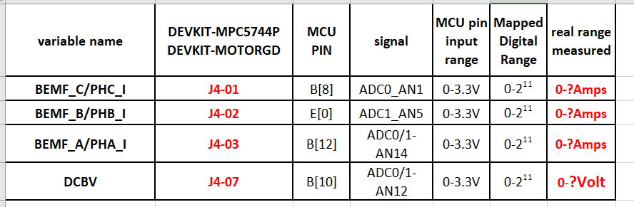

    • It is regarding DEVKIT-MOTORGD and DEVKIT-MPC5744 pair for motor control, the table attached here is about the current and DC bus voltage measurement on the pair, my questions are:
      1: please let me how much the number in the last column in the table suppose to be?
      2: how BEMF and PH current measurement is sharing the ADC channel? through jumpers? then which jumpers, how the configure should be?
      3: if you see there is anything not correct in the table regarding the pair of the board, please let me know.
      4:please provide schematics for your MOTORGD, if you do not have the updated version, the old version is fine to me.
You can only choose between BackEMF or Phase current measurements one at a time. That is selectable via the J9/J10/J11 jumpers. There is a small legend on the board layout that tells you in which position the jumper should be.
Basically if you short 1-2 pins it will measure the phase currents (PMSM) while 2-3 position will measure the Back-EMF in BLDC mode
All the measurements range and resolution depends on J8 position.
J8 - short: the Vref  = 3.3V
J8 - open: the Vref = 5V
The DC voltage @5V Vref:
range= 0 to 45V
The DC current measurement @5V Vref:
-25 to +25Amps
The Phase Currents @5V Vref:
-31.25 to 31.25Amps
The Phase Voltage @5V Vref:
-Vdc to Vdc
Where did you got that information about J4 header? The correct routing is:
