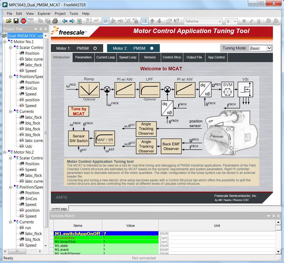

Hi guys,
   I bought the "MTRCKTDPS5643L: Dual 3-phase PMSM Development Kit with NXP MPC5643L MCU" the Web:Dual 3-phase PMSM Kit with MPC5643L MCU|NXP ,but i don't konw how to use it,i haven't the Model software demo of the MTRCKTDPS5643L,Can the NXP provide  the Model software demo about the Dual 3-phase PMSM Development Kit with NXP MPC5643L MCU?
Friends!Help me!
Eden Li
531 Views
dumitru-daniel_
Hi Eden Li,
For these kits the NXP is providing the reference application as C-source Code and the FreeMASTER with MCAT option to tune your setup.
 If by "Model software demo" you meant to say Simulink model example for such setup - then i'm afraid we do not have such models.
Anyhow - you have all the bits&pieces in the Toolbox for MPC5643L to allow you to replicate the Reference design example. In case you have issues with modelling we are more than happy to assist you thru the modelling process.
