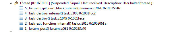

I found more information regarding this issue.  My project contains an RTCS httpsrv web server.  When audio is playing and httpsrv is running an http session task there is a possibility that upon task exit the http session task will crash.  The stack trace looks like this:
This crash only happens when audio is playing.  The only correlation that I see is that the sai dma driver is using an lwsem in the ISR to signal that audio task that an empty buffer is ready.  I notice that as the httpsrv session task is exiting there is a call to _lwsem_post().

Your problem could be related to memory corruption but it is hard to identify the reason of it, more information from TAD like task's status, socket and stack information could be helpful. (Even if we could reproduce this issue on our side it would be better but do not know if specific setup is needed).
Also, I can recommend you to use MQX 4.2 due RTCS and SAI driver are more stable in this newest release. (SAI driver is quite different in MQX 4.2 in comparison with MQX 4.1 but looks more stable), however, if migrating this project to newest release is complicated, we can give a look to your current project.

I have new information regarding the issue.  I forgot to mention in the original post that the board has DDR on it and the project is linked such that MQX uses DDR instead of SRAM.  I wondered it there was an issue with SAI DMA and DDR timing.  As an experiment, I modified the SAI driver to allocate buffers from the SRAM pool instead of the DDR pool.  The reliability of the system improved dramatically.  I was able to play audio in a loop continuously for 12 hours.  During the 12 hour test I ran a shell script that requested a CGI function in a loop.  This script had no delay, just an infinite loop calling wget.
I have not observed any crash if I start the audio output and then start the wget script.  However, if I change the order and start the wget script first and then audio output. I have observed a crash, but only once.  Very hard to reproduce.

I do not know if issues on SAI + DMA are presented when using DDR configuration (although they seem to be there, similar case occurs in USB when using DDR configuration instead of SRAM, communication's throughput gets impacted), but it can explain your behavior when using DDR.
I would suggest to use SRAM configuration instead of DDR and if problem persist, we can investigate it further.
