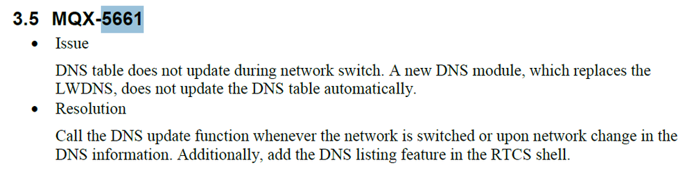

Is there anyone with problems getting #DDNS to work with connection to #DHCP with MQX 4.2

Hi Robert:
I would suggest you refer to MQX 4.2.0  and patched 4.2.0.2. In this version, we fixed one DNS bug, it seems related your issue.
